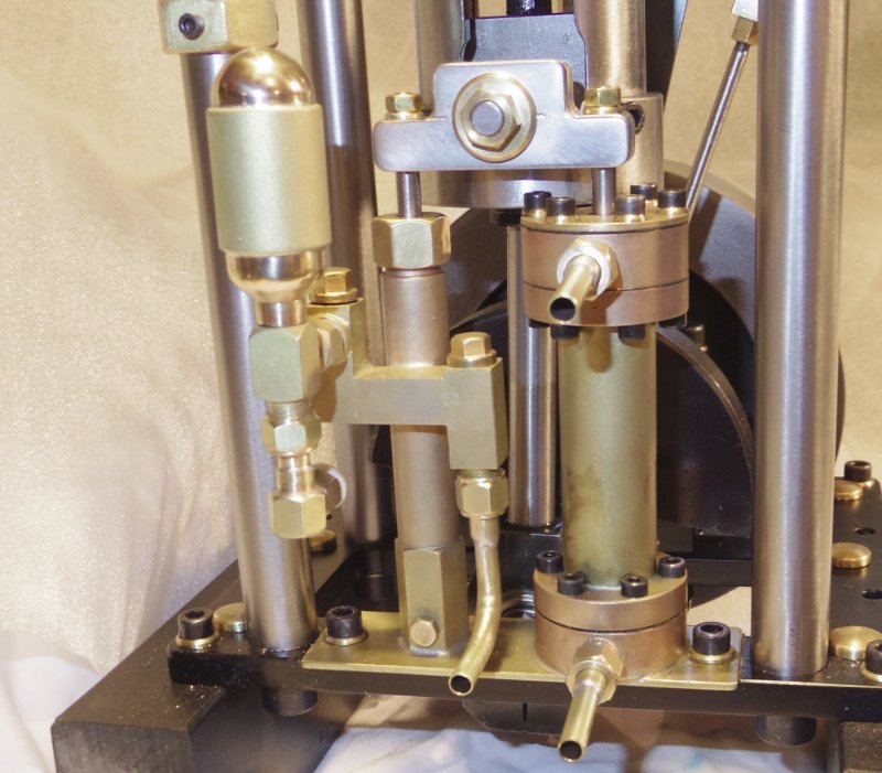

- Posts: 290
Re: Boiler feed pump ?
I have a pump unit (Boiler feed pump with an air vessel and condensate pump) at my engine. It is direct driven from the crosshead.
An injector is also a steam driven pump - i prefer it. There will no steam lost and the feed water preheated.
