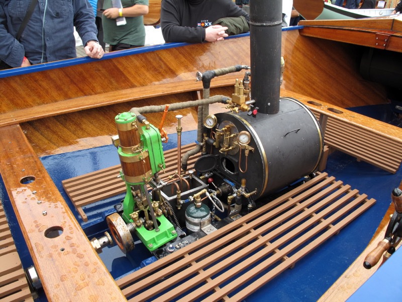

Specifically, I have a Blackstaffe boiler, design in the 1960s, newly fabricated. Picture below.

I hope to hear from someone presently steaming with a Blackstaffe boiler similar to mine, as there are many out there.
They use a steam atomized induced draft burner, but unfortunately that burner is missing on my boiler.
I hope to replicate it, knowing they have worked well for literally decades!
In the photo previously posted the burner is visible. But it disappeared from then, to when I was able to rescue the boat.
The flywheel was also missing. Not a big issue for me to make a replacement flywheel. The burner? I need to know its design.
I believe those items and some more of the new plumbing fittings were all scrapped when the builder's shop was sold off. Sigh.
To be continued.
~RussN

I have disassembled and evaluated the original (1964) oil burner from the Blackstaffe boiler that I am selling (with engine, FG Poulsbo hull, prop & shaft.)
Now I know orifice sizes needed to operate these systems. I will not "steal" this atomizing burner for use on my new Blackstaffe boiler, despite my desire to do so.
Next task is to fabricate an equivalent steam atomizing oil burner, knowing the original fuel was most likely kerosene (paraffin). I have decided to burn that in my new steam launch, assuming I find a good local source for it.
