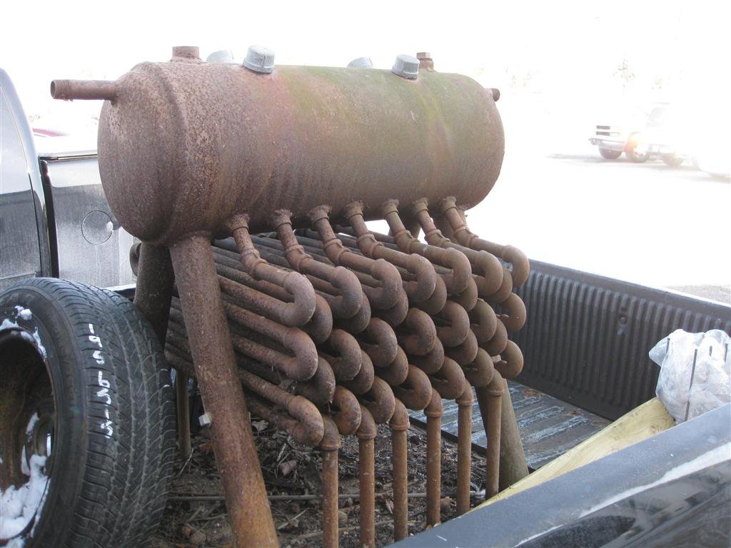

There are some Whitney compound reproductions around.
Funny story: My buddy Gary has been in to Steamboating since Bill Durham was writing that magazine. When they put all the magazines together in a book, Gary bought it. He was going through there reading everything he could, even the want ads, that's how Gary is, he's a walking encyclopedia of Locomotives, Motorcycles and Cars. I've tried to stump the guy, it's nearly impossible.
Anyways, he was looking through the ads in that book and he seen one with a Whitney engine and boiler out on Grosse Ille in the Detroit River. This is in like 1978 etc - whenever that book came out. So he picked up the phone and called the number, unbelievably the guy still had the boiler, but had just sold the engine - the Whitney compound. It went out east to a guy named Webster (some of you know him). Reportedly, they pulled the engine apart and copied all the castings and sold them to various people. I seen one in a lifeboat at a meet. If you see one of those for sale it could be and most likely is, a reproduction.
Gary bought the boiler and brought it over to me and I shot pictures of it.
I have studied George Whitney quite a bit, he was an amazing man. Boston Tech/MIT grad, started out working in his uncle Amos' machine shop at 13, that Amos Whitney of Pratt&Whitney. His Great grandfather was Eli Whitney of Cotton Gin and firearm fame. George opened his own boatyard and started building steamboats, boilers and engines for the well to do Bostonian's. One day testing a new steamboat, he ran in to Sylvester Roper and the two immediately became friends. George went to work for Sylvester and together honed their steam knowledge. Around 1895 undoubtedly learning much from Roper and his 1864 Steam carriage, George built his own called the Whitney Motorette. To my knowledge he never went back to steamboats after that. He sold the patent to the the car (which was likely the patent for first production American car). He went to work for a few different steam car makers and then went on to design asphalt paving equipment in 1907. I haven't found much info on him past that. He was pretty well set financially by that point, he sold his patents and won a few big lawsuits.
