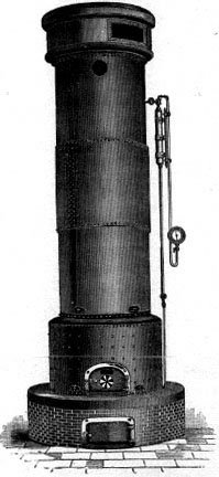

If you are going to mention vertical boilers, don't forget the Manning Vertical FireTube boiler.
High Pressure Manning Vertical FireTube Boiler
Nyitra's ASME Boiler is inspired by the Manning VFT Factory boilers that had a wider diameter in the firebox area at the bottom.

Wow, the manning boiler really takes it up a notch in built height. Perfect to spare space on your pontoon boat of which I am a big fan.
