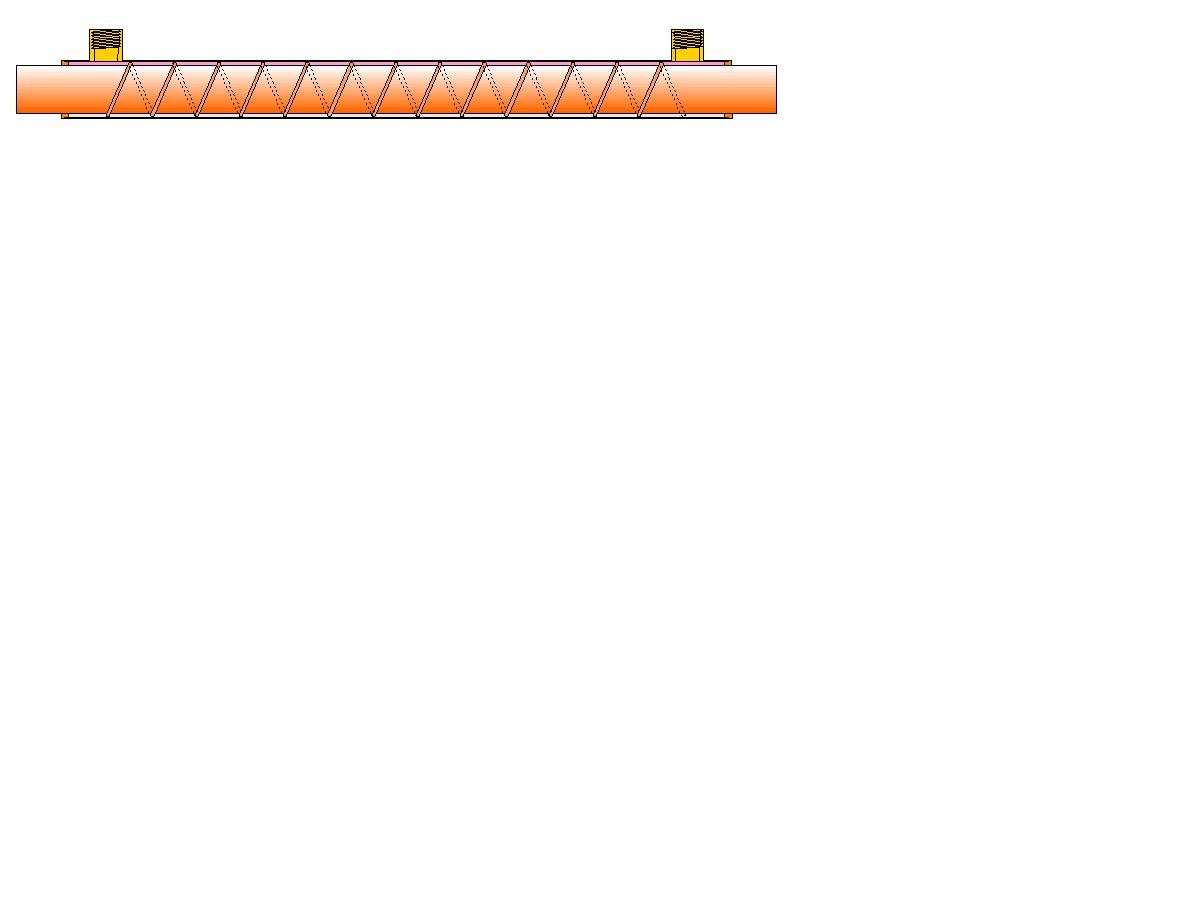

The feedwater heater is simply a 1 inch diameter copper steam exhaust pipe, with a 1-1/4 inch diameter copper outer casing telescoped around the exhaust pipe, silver soldered, about 15 inches long. Feedwater is 1/2 inch copper tube, with compression fittings on each end of the 1-1/4 tube. A copper wire is wrapped around the exhaust pipe, making a spiral path of several rotations when the feedwater travels from inlet to outlet. The steam connections are ordinary automotive heater hose with hose clamps.
Feedwater enters at about 70F, and exits at 194F, with exhaust steam at atmospheric pressure, 212F. That amounts to about 10% higher steam production capability in the boiler, as heating the feedwater from 70Fto 194F is heat transfer that the boiler no longer needs to perform.
