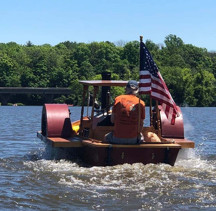

The Margaret S. is in its 10th season, and has been stoked up a bit this year. Made new admission/exhaust valves, and increased steam pressure from 100 PSI to 150 PSI. Added a feedwater heater, so the feed to the boiler, which was about 70 F (lake water), now enters the boiler at 194 F, allowing considerable increase in steam production. The original Propane burners can only hold 125 PSI now with full gear, as the engine is not only making more power, but also using more steam. The Propane burner jets need to be drilled out about 10% to allow maintaining 150 PSI.
Margaret S 2020a.jpg (127.67 KiB) Viewed 101888 times
An old sexist remark, usually incorrect in this politically correct society, is probably OK here, as the statement is about a boat:
"She's beautiful, and she cooks"
