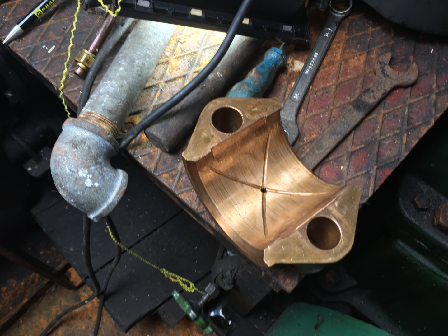

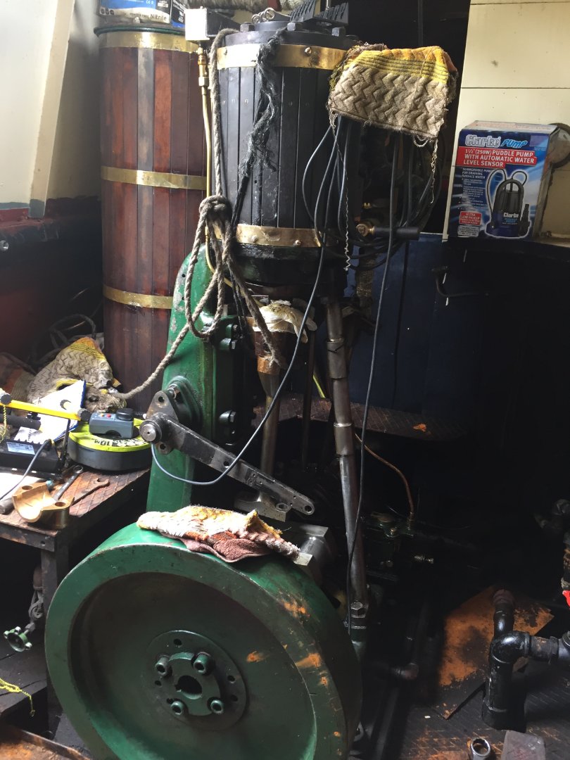

Mostly for general interest, here are some pictures of an engine I was privileged to work on today.

Unfortunately is has a heavy clonk, seeming to come from the bottom end. (I personally haven't heard it, but am guided by someone who has)
I've measured the crank pin at 2.994" all over, and though it has a couple of 'marks' on that I will erase with some fine emery and oil, looks good. They really are not serious.
Re: Vintage Steam Engine.

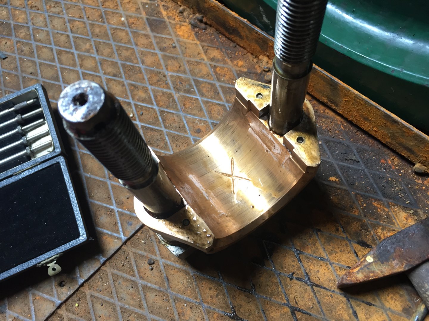

I reassembled the bearing, off the shaft, and the measurements are nowhere near as good, 3.004" - 3.006", but there are no signs of serious wear. In fact not a lot more than normal bedding in. 0.010" seems rather a lot, I would have expected something less than 0.001" per inch dia. It's an easy fix as there are slippers either side than can be reduced to close the excess. My thoughts are perhaps to remove a touch too much and set back up with shims, which could be removed/adjusted at a later date when things start to rattle again. Thoughts?

Yes: A good idea to mill down the slippers and install shim packs for easier future adjustments.

Make your own shim packs. I sandwich the shim material between 1/8 aluminum plates then drill holes and mill as needed. The shims for the lower conrod bearing were drilled then put into the assembly and filed to the profile.

This one means two sets of shims as the slippers are handed, though the difference seems to only be the guide spigot holes, I suppose it might be possible to make a common set if the spigots allow.

With 0.010" clearance on a 3" crankpin you'll definitely get a healthy 'clonk'. From http://edge.rit.edu/edge/P14453/public/ ... arings.pdf:
- BartThe basic guideline universally used for diametral journal bearing clearance is 1.5mils-per-inch of journal diameter. That is, a 4 inch diameter shaft would need about 6 mils of diametral clearance. Always check if the specifications you see are for diametral clearance. Some manufacturers specify radial clearance- which is really difficult to measure! If the application has atypical loads and/or speeds, then this clearance rule may need to be adjusted.The bearing should be held in the housing with a zero to 1 mil interference fit. A loose bearing will have vibration problems and too much housing interference can reduce the clearance in the bearing. The issue of tolerances should also be considered. Clearance values are usually given as a range. The limits suggested here for minimum allowable clearance is 1.0mil-per-inch shaft diameter plus one mil. The maximum allowable is 2.0 mils-per-inch. Remember tolerance costs money.
Bart, my problem with this one is that it appears it may have come from the manufacturer that way!
There is very little ovality in the bearing, maybe 0.0005" indicating that is near enough the size it was machined to.
The consensus now is to remove around 0.012" from the slippers and insert a 0.004" shim, with some other thickness's on stand by, re-assemble on the pin with a touch of 'blue' and check for high spots. I have advised that the oil be changed from the current SAE 140 to something a bit thinner, at least at the start.
This thing is turning a BIG wheel, 36" X 48"!
