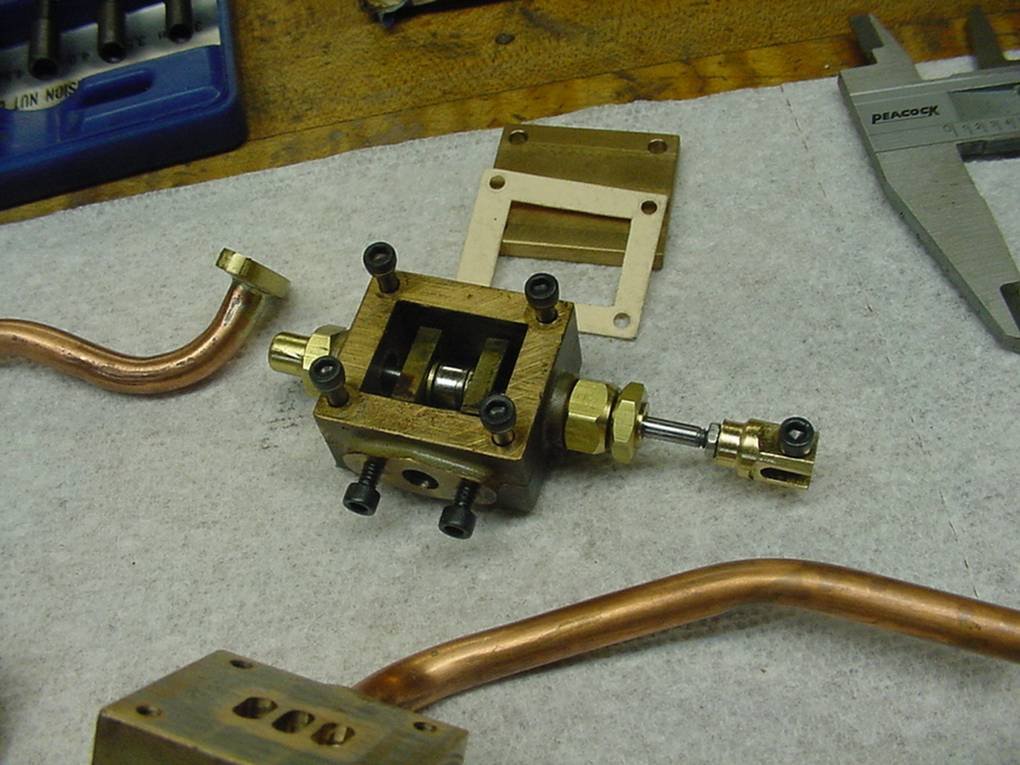

Here my solution of a valve rod.
where was it broken. Only if this is known can it be changed successfully.... had a broken 5/16" H.P. valve rod.

dampfspieler, you have an excellent method of clamping the valve travel block to the valve rod, with infinite precision available for fine adjustment. I will follow that method on one of my future builds.
For small engines, I have made the valve rod longer, allowing bearing support at both ends of the steam chest. That can give good guided travel, without an outside slipper guide. Make the valve rod somewhat larger to complete that arrangement.

The one I fixed and the one I was told about both broke right where the threads started. Smaller effective diameter and some sharp edges resulting in stress risers.
I like your extended rod not that it would help the breakage at the threads so much but that it should reduce friction due to poor rod alignment.
Your clamping design makes for a good solution to the thread wearing where it goes through the valve block. You must, of course, still allow some play so that the valve can slide on the port face freely.
I prefer my piston valve with inside admission so that the valve rod packing gland is only exposed to the throttled steam. Much easier on the eccentric as well.
