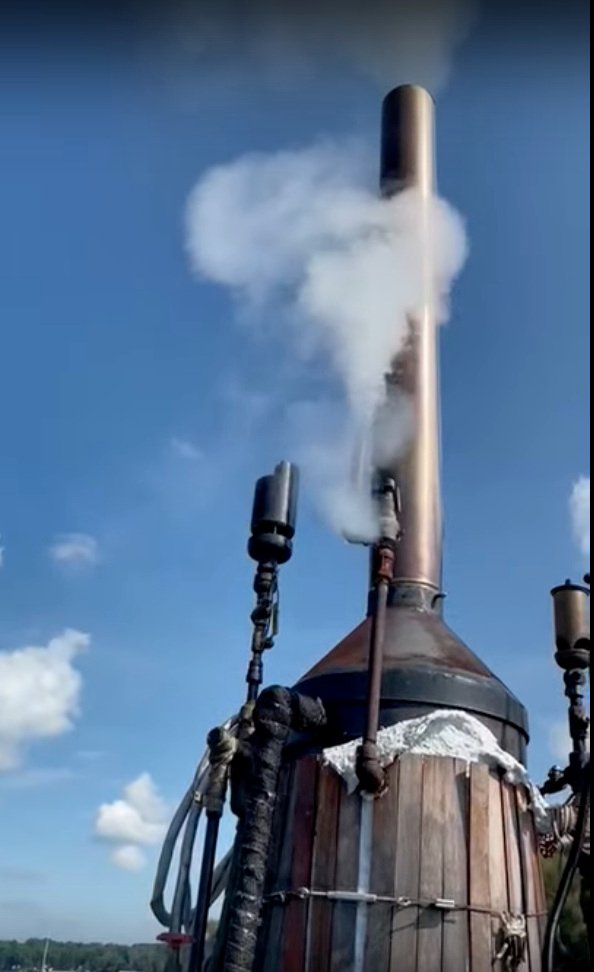

It's interesting how the sound carries, and how weather can affect it. I think that deeper sounds generally go further.
A few times I have whistled back and forth across lake Chautauqua with the Chautauqua Belle. But on other days I've been on the phone with someone only about 1 mile away on shore and they couldn't hear my whistle.
Lake Chautauqua is 18 miles long, being between 1-2 miles wide. My launch Nyitra is usually moored in Point Chautuauqua, and the Chautauqua Belle is in Mayville, about 1.7 miles away across the lake.
In the last year I mostly reach for my larger steel step whistle, 3 note. I think it is a deeper sound and generally carries further then the more shrill Crosby brass 3 note chime.
I have never had a chance to personally hear my boat from afar because I'm always the one running it. From neighbors in Point Chautauqua have said they generally enjoy hearing the whistles.
Boiler pressure definitely affects the amplitude of the whistle.
Steel Step whistle (3 note) on left. Brass Crosby whistle (3 note) on right.
