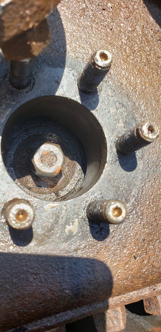

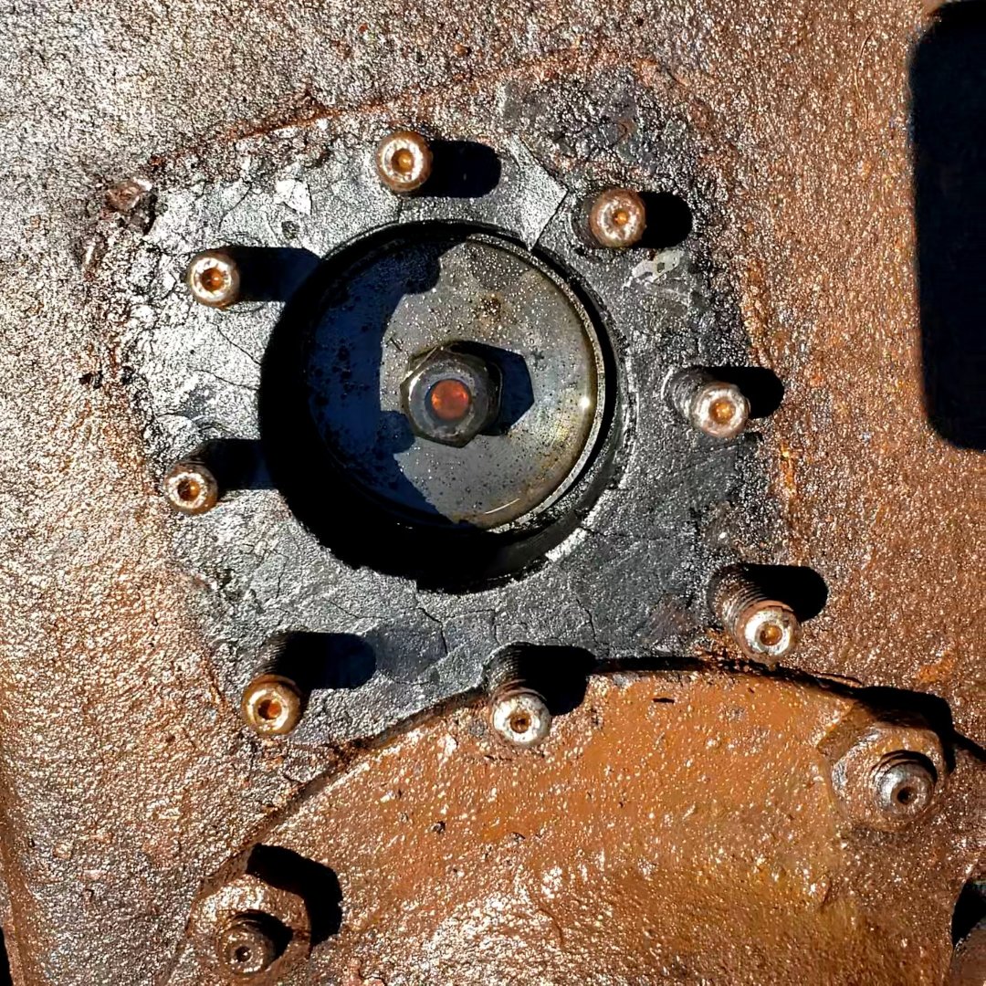

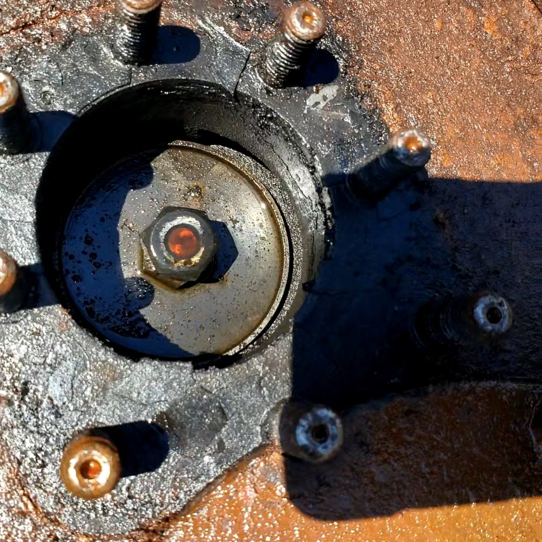

Initial observations are promising.This is the low pressure cylinder piston valve.

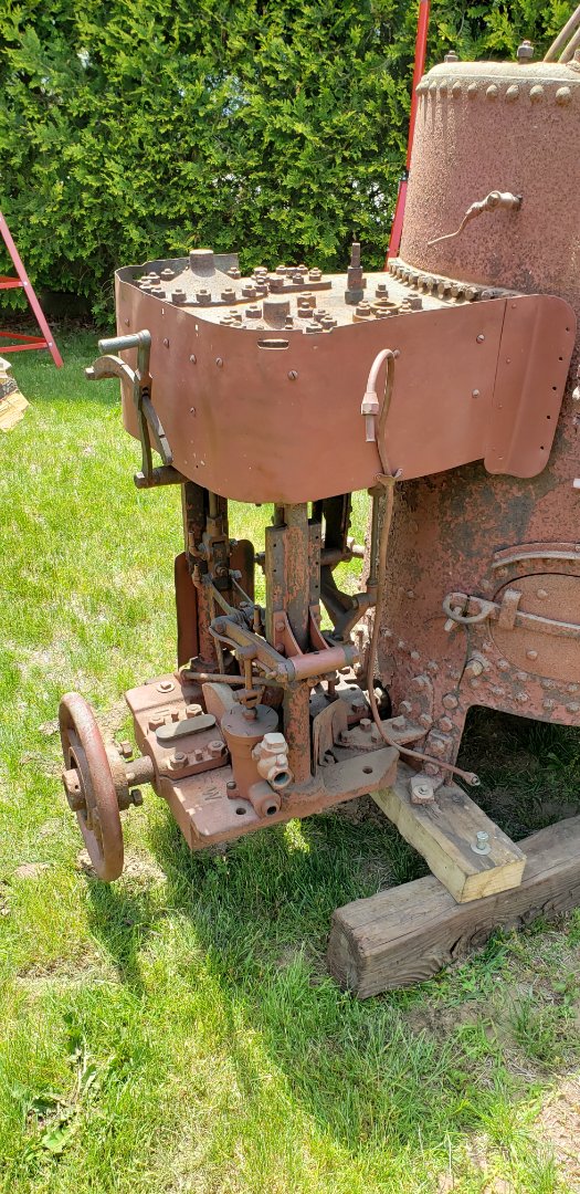

Never say never when it comes to a restoration. You should see the steam carriage that I'm restoring, there was virtually nothing left. Looks like most of the damage is external. Some sandblasting and paint, piston rings, some brass bits and bobs and you'll be back in business.

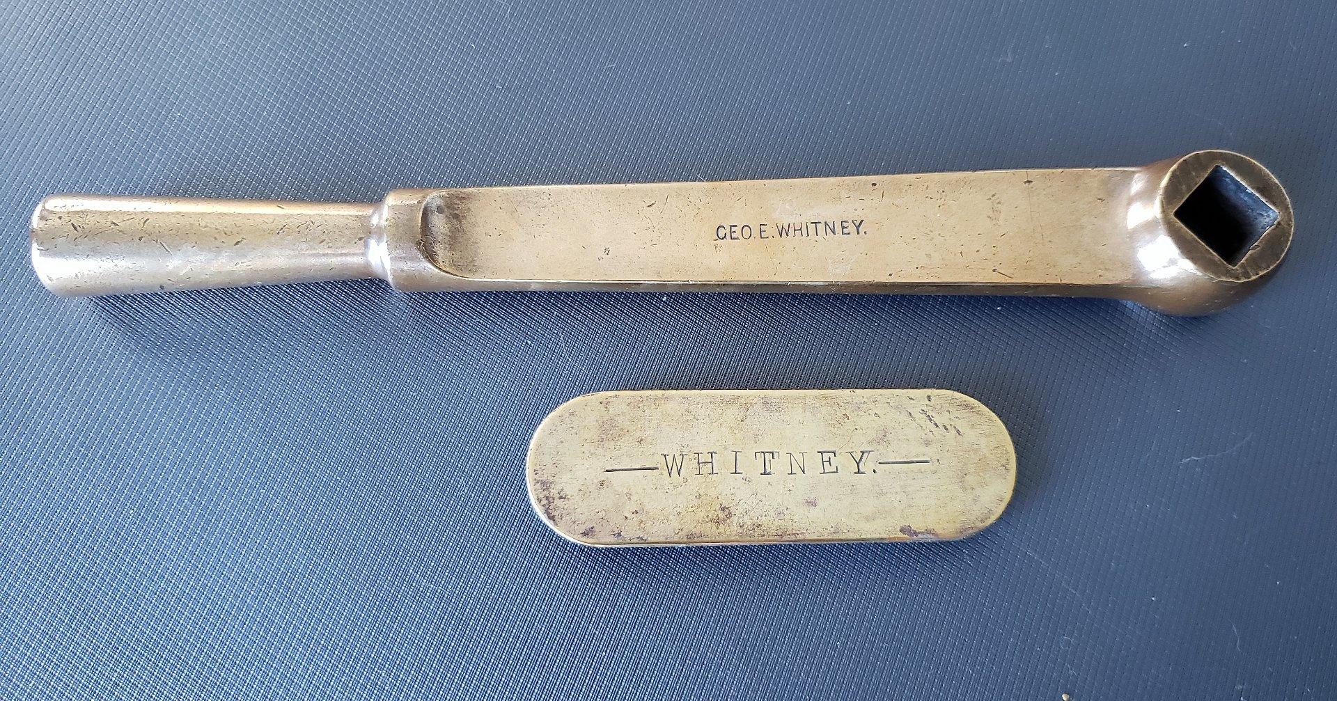

I am encouraged. The high pressure valve looks good too. A couple of the shiny bits survived. The throttle handle and the main bearing cap.

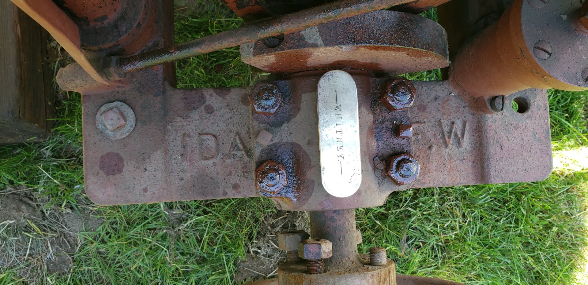

Tom, Is that an original Whitney engine? Do you have any History on it?

DetroiTug wrote: Tue Jun 22, 2021 12:09 am Tom, Is that an original Whitney engine? Do you have any History on it?
Ron
Hi Ron,
Yes. This is the Ida F.
Named after his daughter. George used Ida F. on Island Pond in NH for 48 years.
I think I know almost everything about her.
She is quite special.
