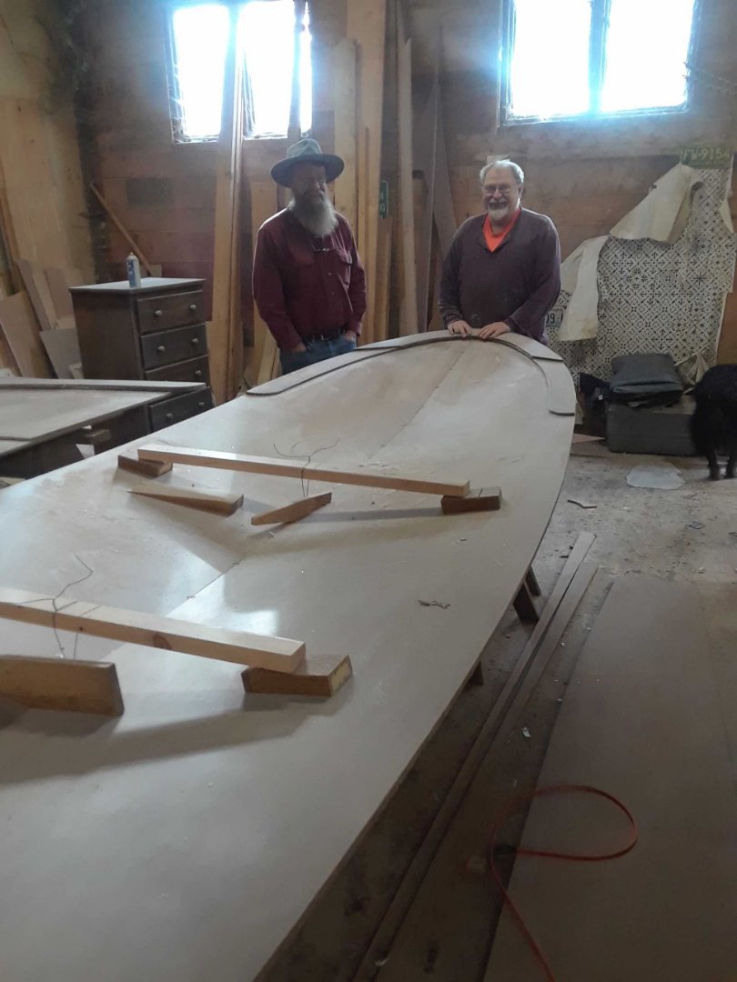

First picture:
The two bottom sheets have been cut out, wired together, pulled out to the correct angle and and braced in position. This one picture is an example to the entire construction process. There are no chine logs. No strongback. The bulk heads are not critical to the strength of the hull. It doesn't seem quite cricket to have the shape just happen like this.
On the right is Scott Hauser the boat builder. On the left is NOT a member of the band ZZ Top. It is a boater and electronics engineer friend, Tycho.

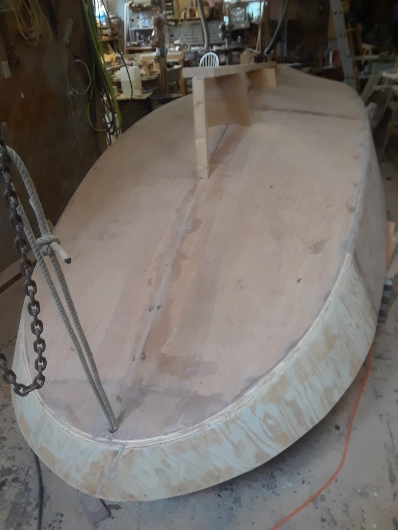

After a some intense efforts including attaching the sides, building the fantail stern, attaching a black Locust stem and I forget what else, we turned the hull upside down and started to build the keel. Note that the keel is, at first, an add on structure. When completed it was then bonded permanently to the hull. The the hull was turned again and the bottom area of the hull over the keel was unceremoniously cut out and, voila!, the same result as if we had built it all at the same time. Only very much faster.
First a shot of the beginnings of the box keel:

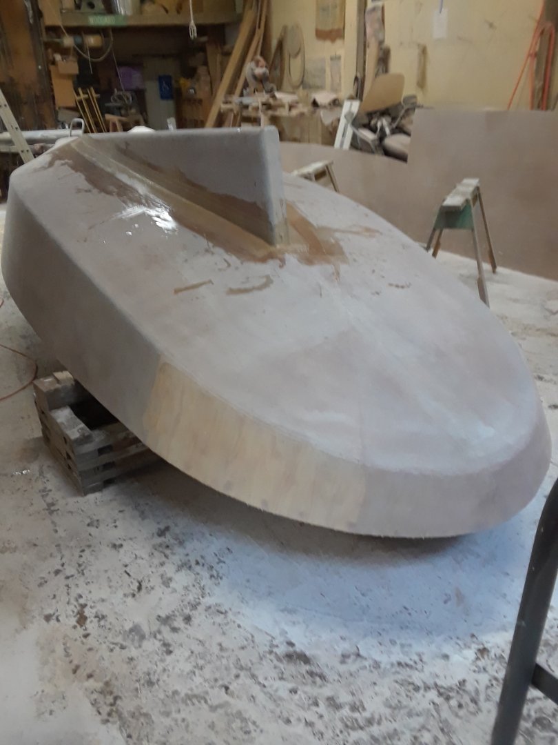

Now a shot of the keel completed and bonded to the hull but before we turned the boat over and cut out the access to the rest of the hull.

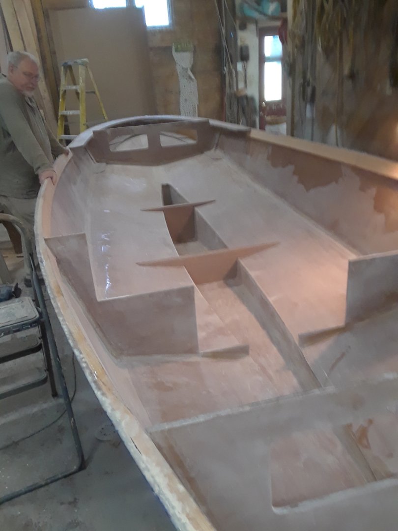

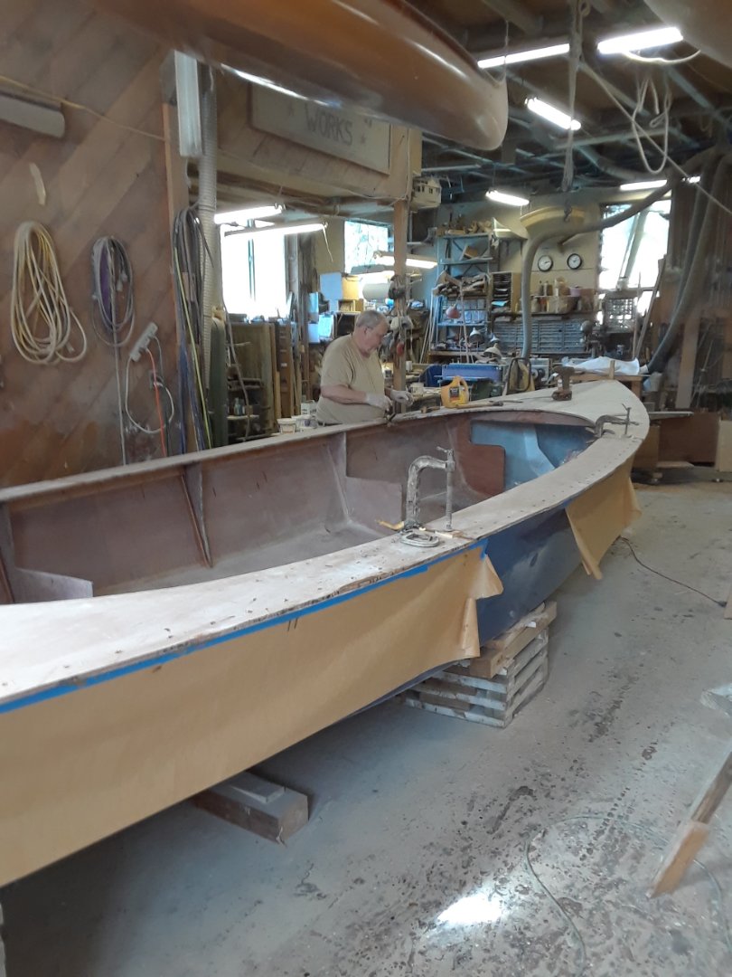

Now a shot of where we were after opening up the keel and installing bulkheads. It was all a colossal mess with dust everywhere, the dog and cat upset and me just doing whatever I was told to do. I'm a machinist and an electronics person. What's all this wood and resin stuff?
Bulkheads with Scott.jpg (86.98 KiB) Viewed 45337 times

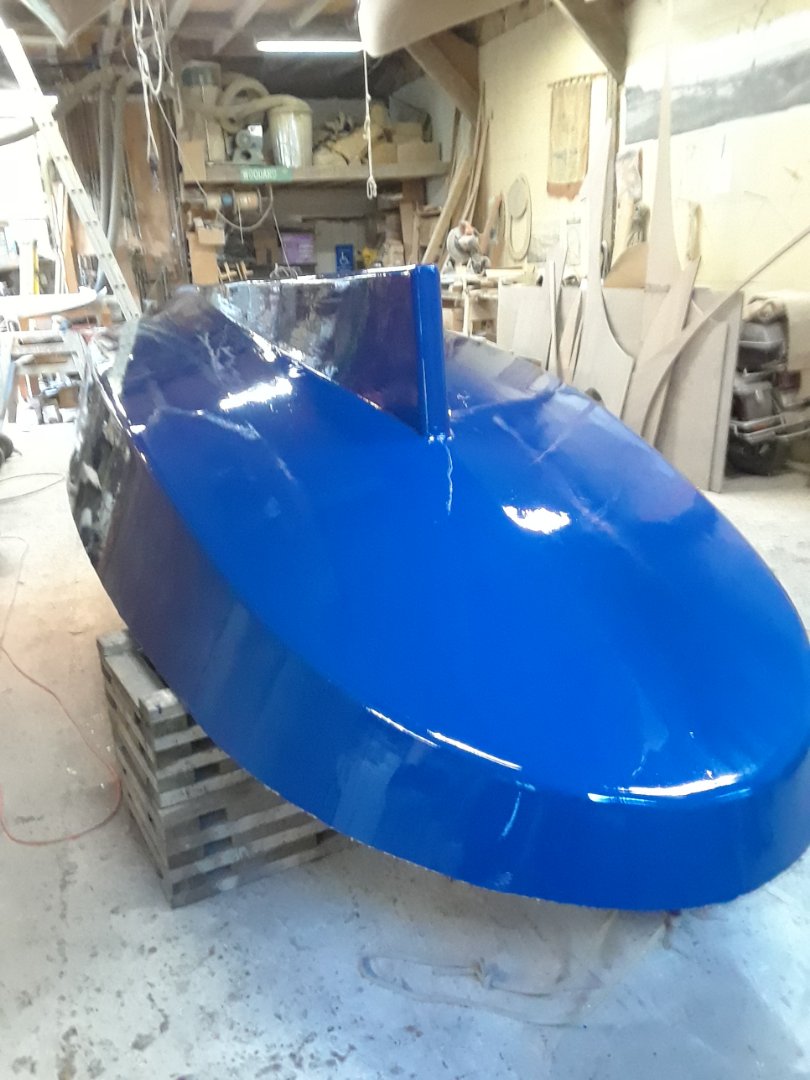

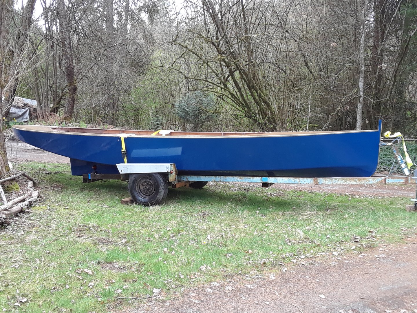

I'll spare you a whole saga or two of priming and painting. To be honest, it wasn't that big a deal. Since the sheets of plywood had been glassed on both sides before even cutting them to shape, there was only some taping of seams and smoothing things out with a disk sander before the prime coat. There was building a small keel forward of the box keel made of solid Locust. The stem is also Locust but is of a small cross section and is is essentially a cap piece over the ends of the plywood edges at the bow.
Blue bottom stern.jpg (119.94 KiB) Viewed 45336 times

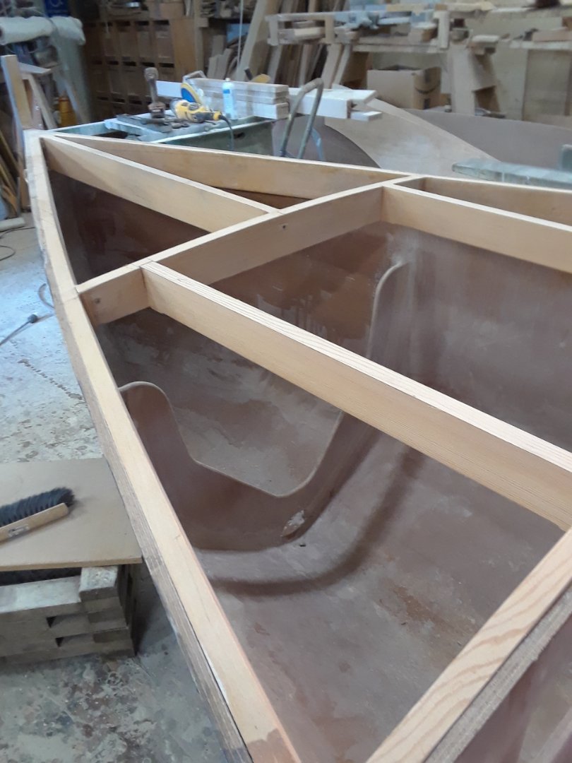

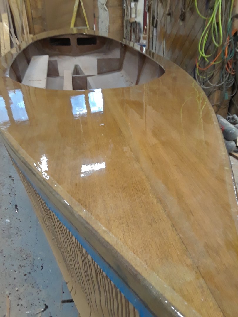

With the deck, we departed from our custom of coating both sides of the plywood with cloth and resin before cutting out the shapes. Too much waste. There are four pieces. Bow, stern and the two side decks. The joins were done with small backing plates. The fore deck crown is so gentle that I built some framing both to stiffen things and make it easier should I decide to add a fore hatch. Then the cloth was draped and saturated. Confidentially I own a rather substantial black powder mortar (2.2" bore. 100 pound weight) and I may be firing it from the bow. Support needed even with a great big pad under it.
Foredeck framing.jpg (117.28 KiB) Viewed 45333 times
Deck work.jpg (133.72 KiB) Viewed 45333 times
Deck resin bow.jpg (117.25 KiB) Viewed 45333 times

So here is a shot of Spiffy on the trailer and headed for captivity and idleness for two years. Covid and pressing matters intervened.
Mind you that thus far the time from the delivery of a stack of fancy plywood until this picture was taken was only a little over four weeks. We weighed it as closely as we could with a bathroom scales and levers. Around 800 lbs.
I went home and pulled the machinery out of Folly, the donor boat, and gave the hull and trailer to a local farmer. I saw it last week headed across his pasture full of cow manure. Very appropriate.
As posted recently, I launched the hull last week with boiler and engine strapped in place to check the trim. Close enough. This hull doesn't seem to be that sensitive to weight. I will probably need to solicit heavy passengers to get the prop submerged!
As of today, the engine and boiler stringers are bonded in. The hole for the propeller shaft is bored. As Scarlett in Gone With the Wind said, "Tomorrow is Another Day,"
