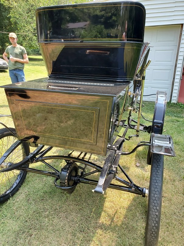

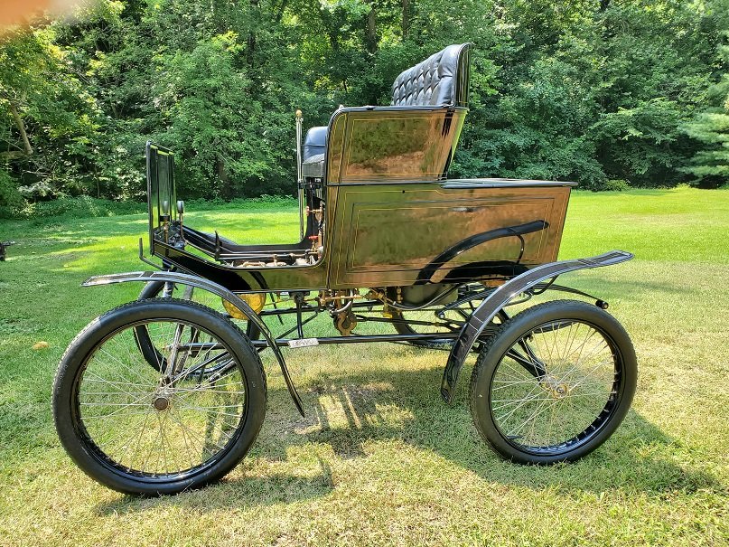

The 1901 Conrad restoration nearing completion.

Hi Ron,
looks great. Where can i find a restoration report?

Hi Dietrich,
Thanks, I have never created a report on this project. It was a very extensive restoration beginning with it's chassis that was destroyed in a barn fire, I had to replace all tubing in chassis, make patterns and cast new front axle yokes. The wood body was in very bad condition and the seat was gone, I made a new seat for it. As well as fenders and dash.

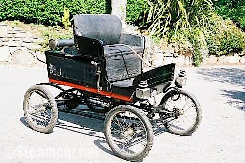

The designs around 1900 for many automotive steamers was strikingly similar. I attached a 1902 Toledo steam carriage picture.
