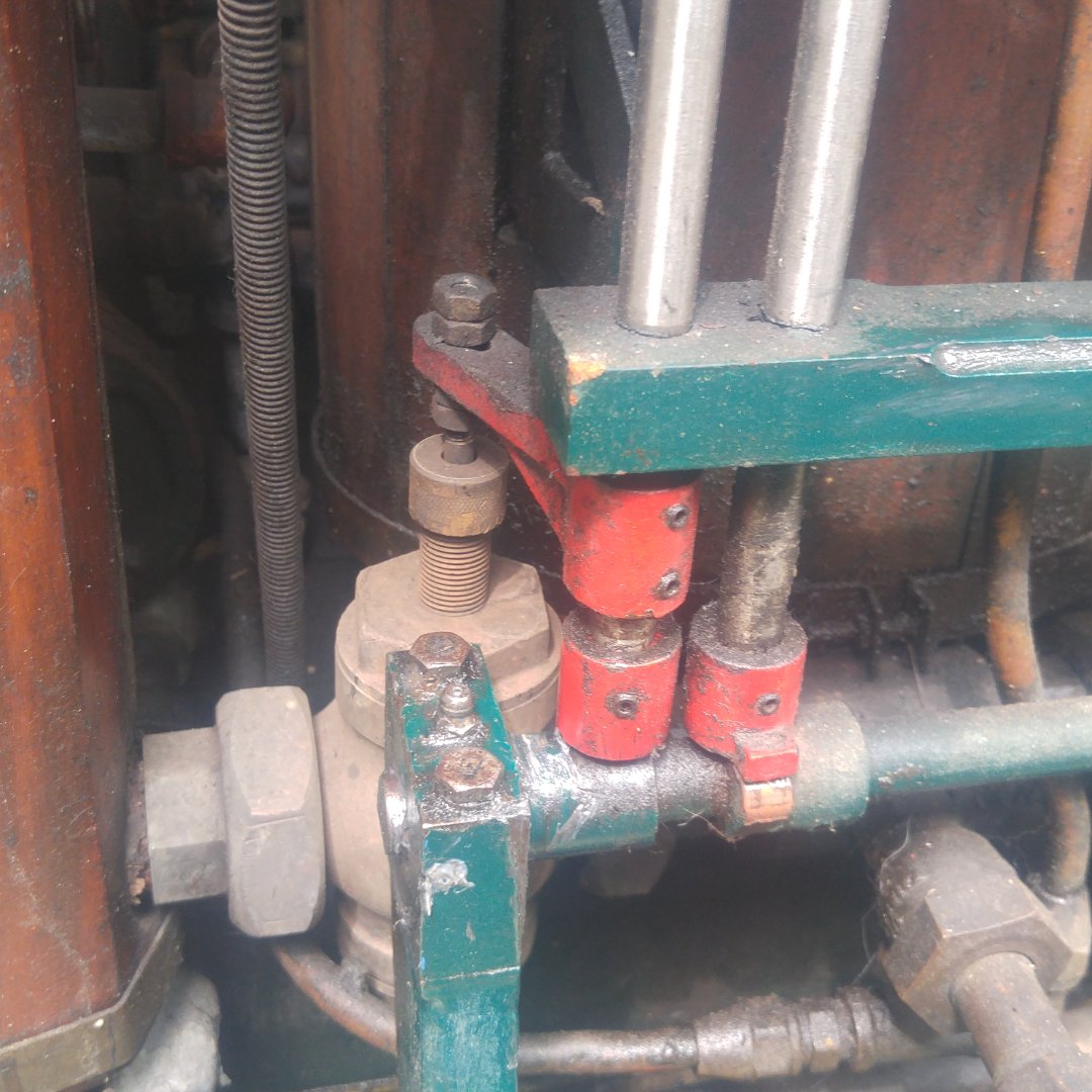

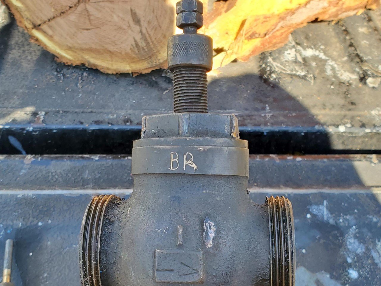

This is a revision to my earlier posting seeking a "poppet valve" for TULE PRINCESS. From my investigations and frustrations in getting my defective valve serviced here by local engine machinists that came highly recommended, I am now BEYOND putting up with any more BS or Cost in trying to fix our existing valve. I have to find NEW. Hopefully from a source that will only sell me the BODY section ONLY. What I need to replace is a 1"NPT Union Connection - Hoffman 1140-05 Body/Valve unit. I don't have ANY use for the Thermostatic Temperature Probe section; just the Valve BODY.
From STATE SUPPLY the entire Thermostatic Temperature Control Unit costs almost $2K - half of which will be tossed. Makes not sense to me. Why can't a fellow get JUST the Body, from somewhere....???? Also, Ebay does not have any offerings for a 1" - 05 Body Style.
TULE has now been down going on 9 weeks in my attempts to get the valve new valve heads, then new valve seats, then they broke the lifting rod, told me she was fixed and able to hold pressure....only to have installed the valve and the problem is still there. Hate to be BS'ed and dismissed as just an ol'steamboat guy. Clearly we will not be using that shop again.

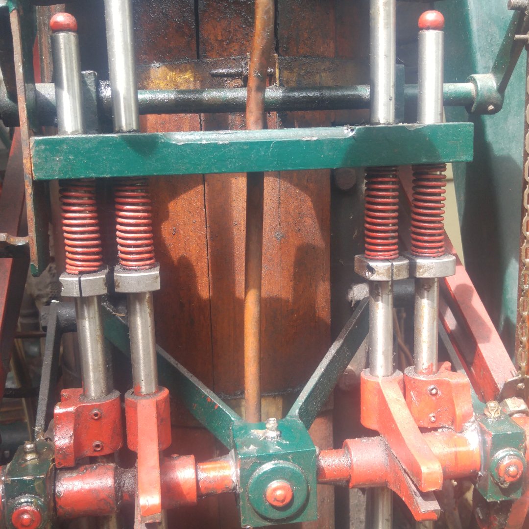

These valves are both Intake (2) & Exhaust (2) on TULE's Walking-beam Engine, design circa 1877.
Pic 1 is the defective valve, Bottom Right Intake.

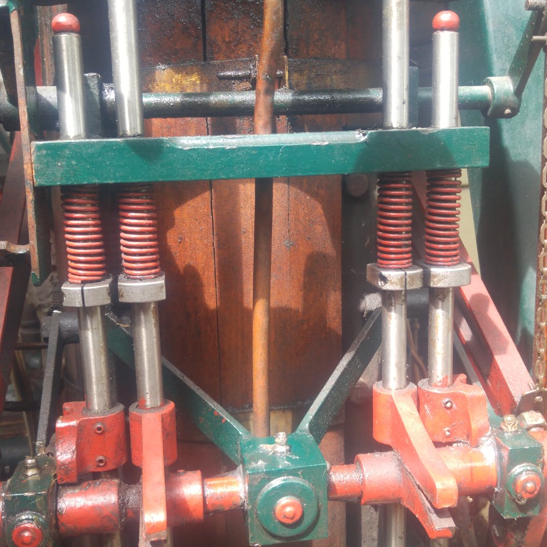

Pic 2 is the Valve Action Cam Assembly.
Once clear of the dock, these engines switch over from manual timing action to engaged eccentric activated self timing.

This is TULE's Walking-beam Valve Action Cam Assembly.

I'd get with someone who has pattern making and machining skills and have a new body cast and then machined. Go on some of the scale locomotive, or home shop machinist forums, this is routine for them.
What about altering a 1'' whistle valve? Which is essentially a poppet valve
My guess as to whats wrong with yours is the guides are worn or the valve stem is bent or worn. Those types of valves need everything tight and perfect alignment.

I found your other thread that shows the valve inside. I Would bore out the old seats and thread them, then make and install stainless seats. Stainless stem and valves also. Then bore out the valve guides and line with 932 bronze. With those tiny bronze contact area valves and seats it was never intended for that type of repetitive service. A new valve would likely only last a season of daily running, you've likely ran the engine more than its ever been ran.
You need a machinist (real one)
