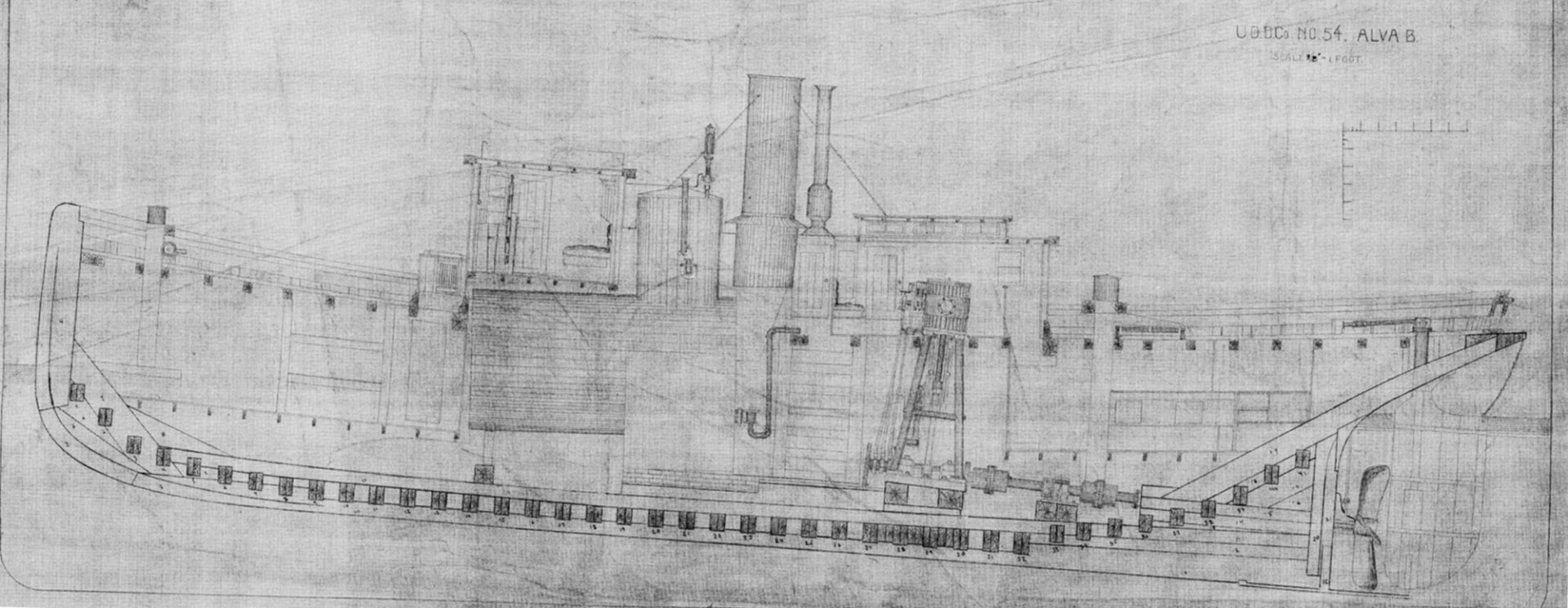

Can someone explain the rocking valves on the Alva B single cylinder tug engine.
Appears to be two valves, and multiple eccentrics.

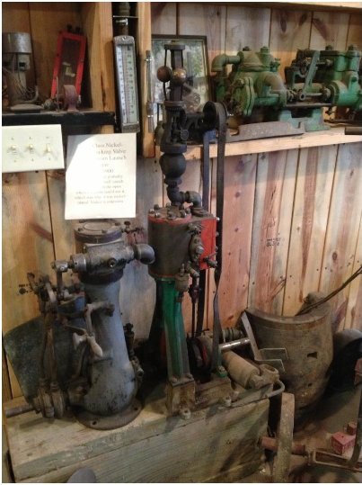

One of the only engines I can recall seeing with a rocking valve was a small bottle engine (photo attached).
I assumed that there would be more rocking valve info online, but I am pretty much coming up empty handed.

The double rocking valve arrangement on the Alva B has me stumped.
From a purely practical standpoint, it would seem that a rocking valve would essentially need to be a D-valve that is stretched/morphed into a round shape, maintaining the same relative port openings.
This is just a guess.
When I first looked at the drawing for the Alva B, I assumed that one valve was for steam, and one was for exhaust, but I can't make that work out at all, and so I am starting to think both valves were for steam and exhaust, and the valves could be operated independently, which would improve efficiency.

I have been searching the net for rocking valve info, and while plenty can be found regarding the Corliss engines, I have been unable to find anything of significance with a rocking valve engine that is not in a Corliss configuration.

Re: Steam Tug Alva B - Engine Question
"The double rocking valve arrangement on the Alva B has me stumped.''
What we may be looking at is rotary valves that are actually two valves in one, an inlet on one end and an exhaust on the other. Another thing to keep in mind is that is a drawing and often times details are not accurate, many old patent drawings are that way. Drawn in such a way to protect intellectual property but still convey the idea.
Ron
Ron
Here is an example of a single rotary valve steam engine:
https://www.youtube.com/watch?v=Sn2NsUXNJAg
Ron is probably correct that the drawing may be partially representative, some of the linkages in the drawing look quite skinny.
