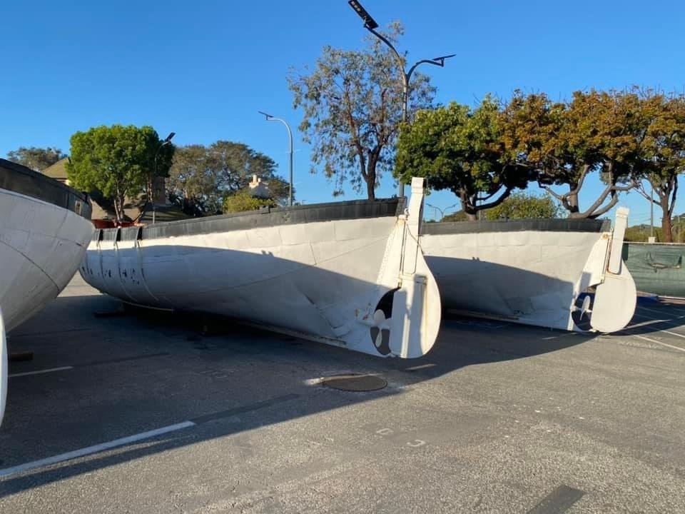

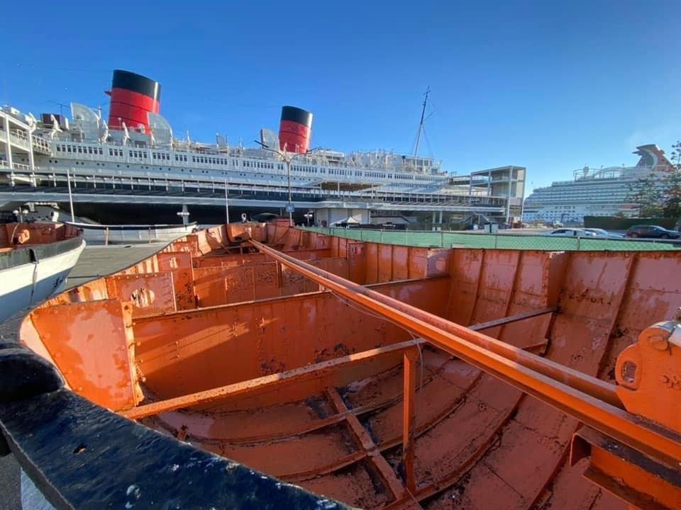

Five 30'+ lifeboats up for grabs from the Queen Mary in Long Beach, California.
They are free. Save them, or they will be cut up/crushed.

Unfortunately I believe they've gone to scrap now. It's worth asking about them though... You may be better off paying to have them loaded and shipped to you. They're quite wide and would likely need a special license/permit to haul.

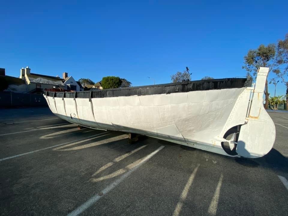

I've had a small bit of experience with trying to make something out of a steel lifeboat hull. It didn't turn out well. The boat was free so I just chalked it all up as a learning episode.
I didn't understand that these boats are not intended to go anywhere at all. Just hang out, wait for rescue and survive just about anything including being launched.
We tried to sail the beast, hang an outboard on it and I forget what else. Towing it was just an frustrating exercise in burning up fuel to amuse bystanders.
For a recreational steam launch, weight is your enemy. These pigs are really heavy. And, as an afterthought, the one I had was galvanized so before welding anything I had to use muriatic acid to strip the area to be welded. Welding galvanized steel produces A: a dreadful weld and B: a sick welder.
I came to the conclusion that these hulls are best installed in playgrounds with pirate themed superstructures.
