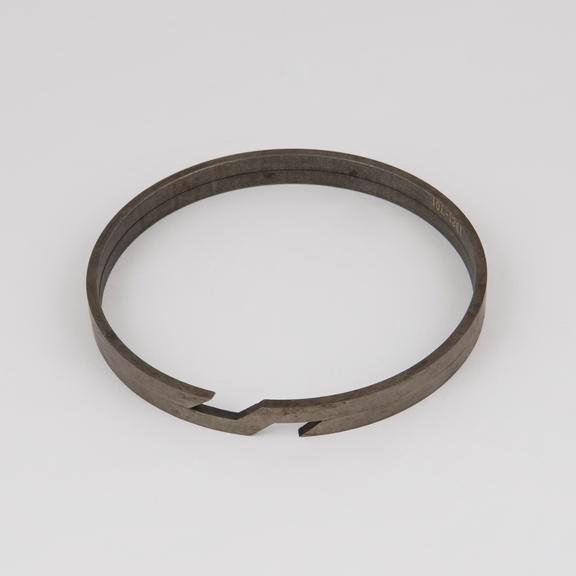

perhaps "Clupet Rings"?
- medium_SMG00020997 (1).jpg (14.28 KiB) Viewed 11026 times

About a zillion small gas engines have a 2.25" bore. They've been working well for me.
Like these: https://www.ebay.com/itm/380211780861

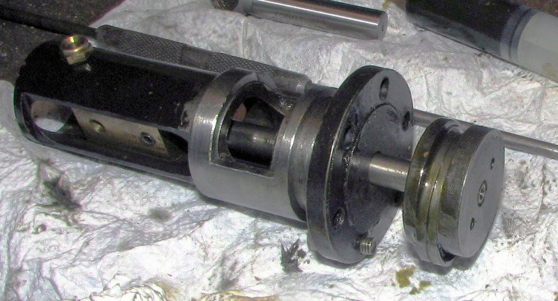

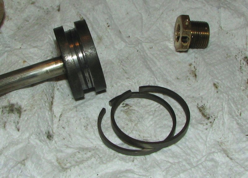

unfortunately I don't know the context in which you work, so it's difficult to give good advice. I have used gray cast iron piston rings from engine construction in all of my current steam engines. But because they have a small gap at the joint, I use two pieces in a groove that are offset by 180° from each other. Because the piston ring groove was too deep for the new piston rings, I made a splited filler ring (not shown).
Here are two pictures of how I did it on my MARTIN steam lorry.
