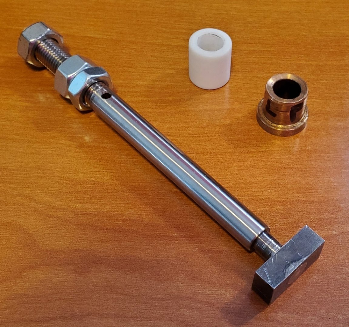

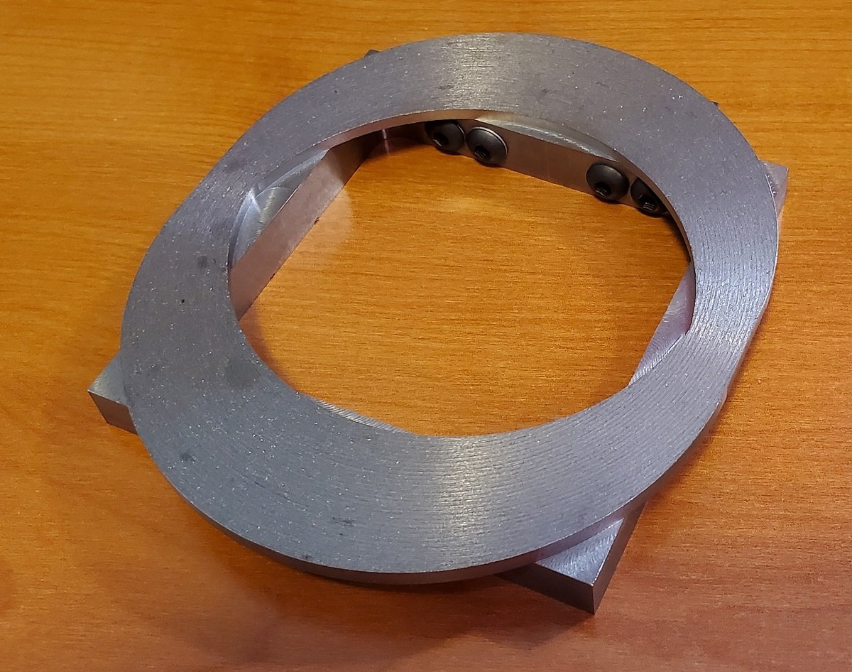

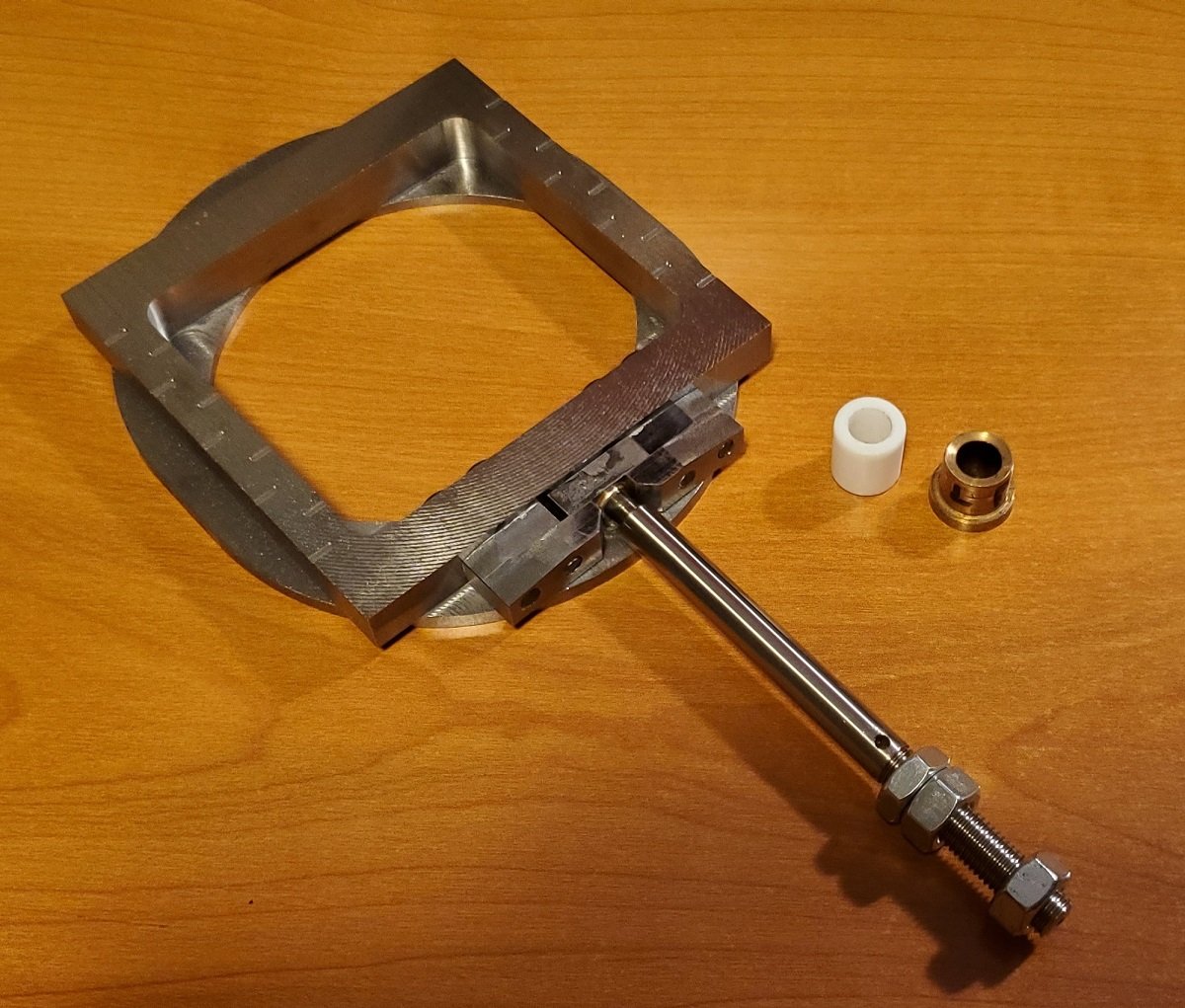

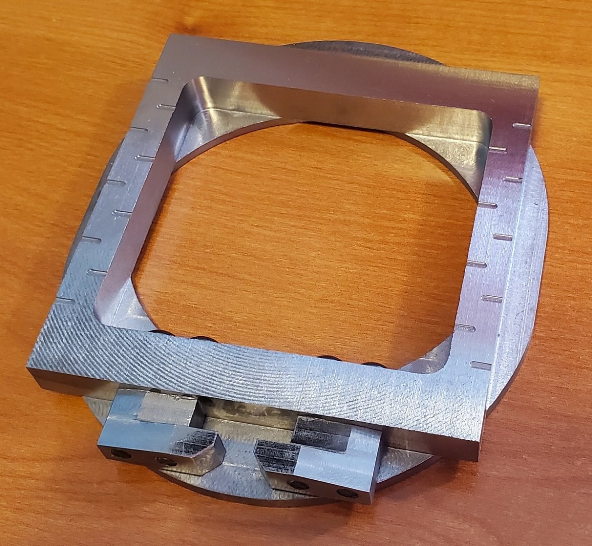

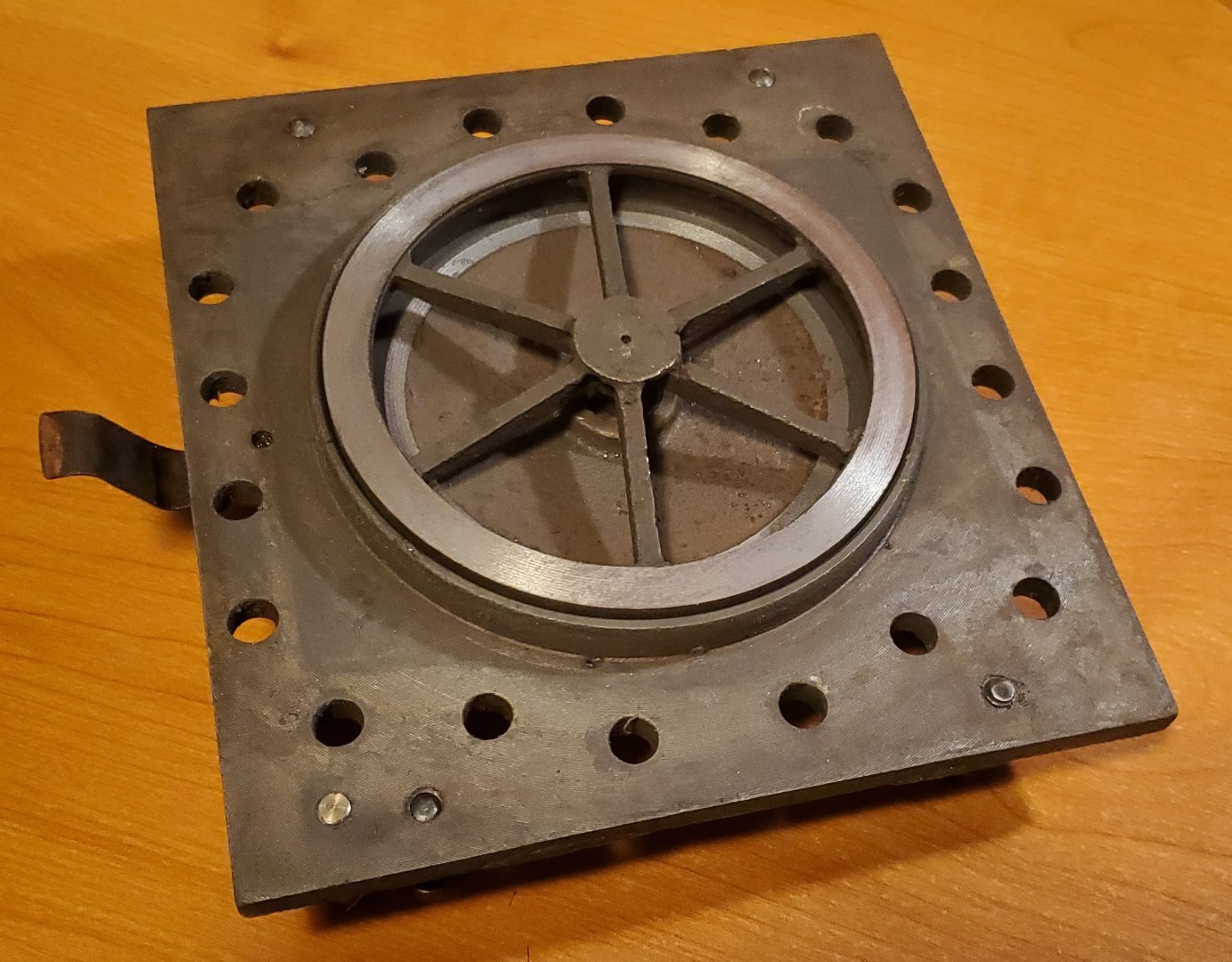

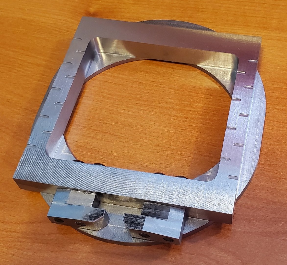

The original low-pressure slide valve in my launch engine needed to be replaced this spring due to heavy wear in the cast in T-slot that connects it to the valve stem, so I hogged the new one from G2 cast iron plate, and to assist with potential wear on the bottom faces of the T-slot, I made those pieces and the block at the top of the valve stem from 4140 steel. The valve stem is Monel.
The dead-end shallow slots along the sides of the valve seat are a feature sometimes seen in locomotive slide valve to allow oil to reach these normally dry areas of the valve.
This engine uses inside admission slide valves, the only time that I have ever heard of such an arrangement. To hold the valve against the seat, a generously sized, spring-loaded balancing piston is provided. As I have said, the designer of this (originally an automobile) engine threw every far-out design feature that he could think of into this project.
New valve stem
Seat side of new valve
Balancing side of new valve
More photos to follow.
New valve assembly

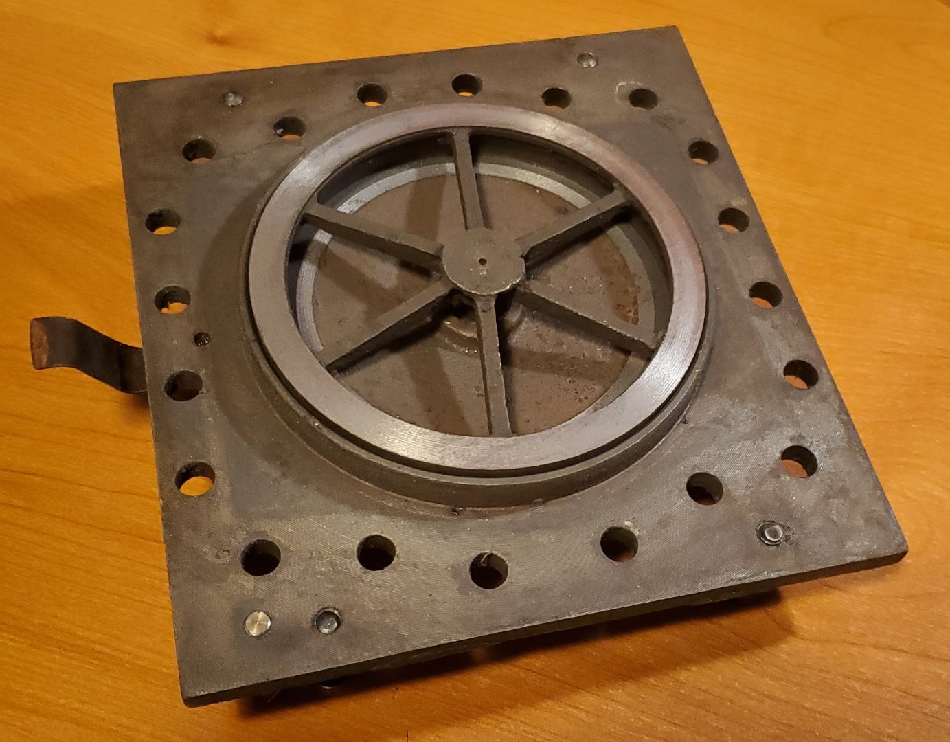

Balancing piston

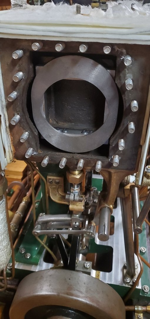

valve installed and set.jpg (102.08 KiB) Viewed 23236 times
Valve installed and set
