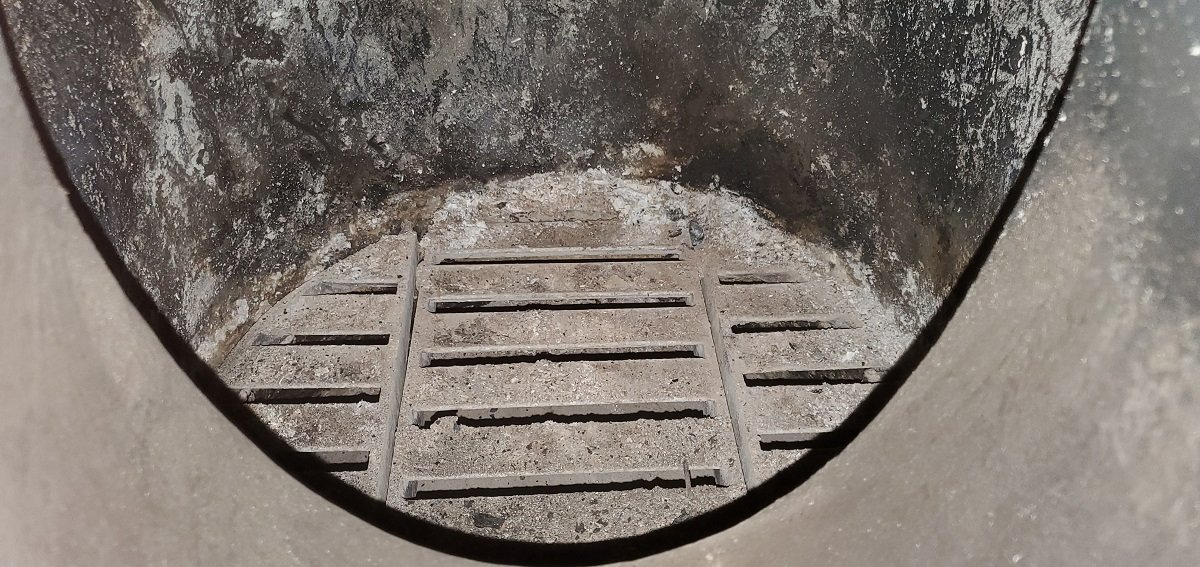

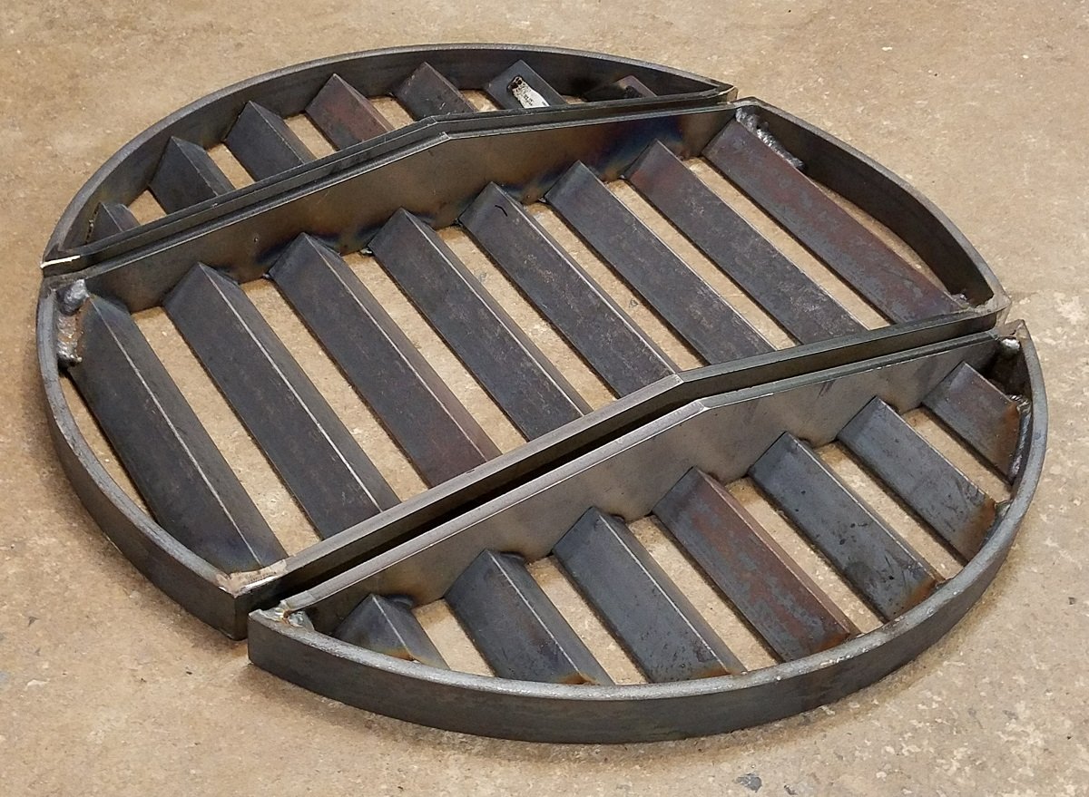

I use a grate, I believe the most folks do. Mine is fabricated from steel angles, with the concave portion up to catch ashes to keep the steel cooler. The space between each angle is 5/8". There has been no sign of deterioration in the grate in five seasons of use.

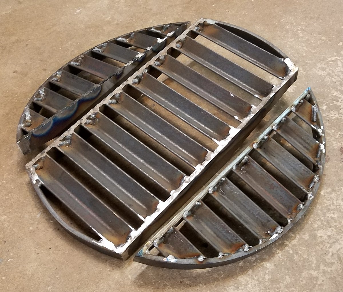

Yes, it is removable through the fire door. It could have fit if made of only two pieces, but I wanted to keep the length of the spans of the angle irons shorter.
The boiler furnace is 17.375 inches inside diameter.
The grate outer ring is 16.875 outside diameter, roller from .25 x 1.00 flat steel.
The angles are cut from 1.00 x 1.00 x .25 low carbon steel. There is a .625 air gap between each angle.
The grate bearers are 1.00 tall at the ends, and 2.00 tall in the center.
The center section of the grate is 7.625 in overall width.
The side sections height of chord is 4.375.
