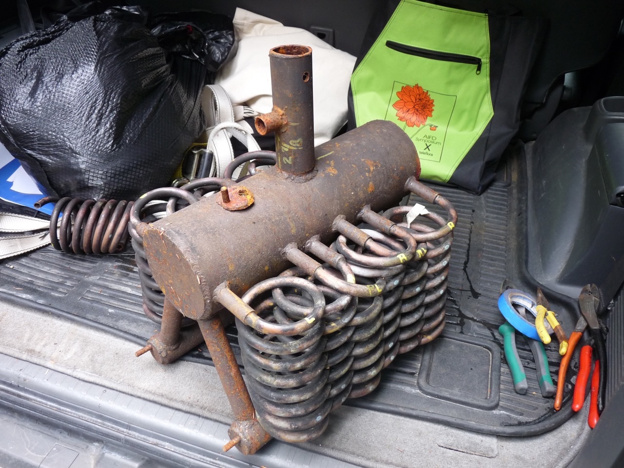

<t>For some reason my first post will not load all the photos as intended. This shows bar burners prior to being turned outboard by about 15 degrees.</t>

the difficulty of a watertube boiler for a user is to understand how they work.
There must be constant water circulation, to achieve this the downcomers must be colder than the coiles. For this reason, the following should be checked and implemented:
A thick layer of soot is evidently deposited on the outside of the boiler, which prevents good heat transfer there. The soot should not be produced with a gas fire and its presence suggests that the flames are, firstly, too large and, secondly, that the supply of secondary air is insufficient.
Unfortunately, you cannot see what the inside of the boiler looks like, but I recommend boiling it with a 1% washing soda solution to remove deposits inside.
All my boilers i fire with gas and ceramic burners. There are no problems of soot and insufficient steam production.
If the gas bottle freezes, the gas withdrawal is too high or the surface of the gas tank is too small to provide the necessary heat of vaporization for the required amount of gas. For this reason, a larger gas cylinder should be used.

The soot you are seeing in the photo is that deposited on the coils when the boiler was oil-fired and is seen in the old casing. That casing is now scrap and the coils have remained clean under gas-firing.

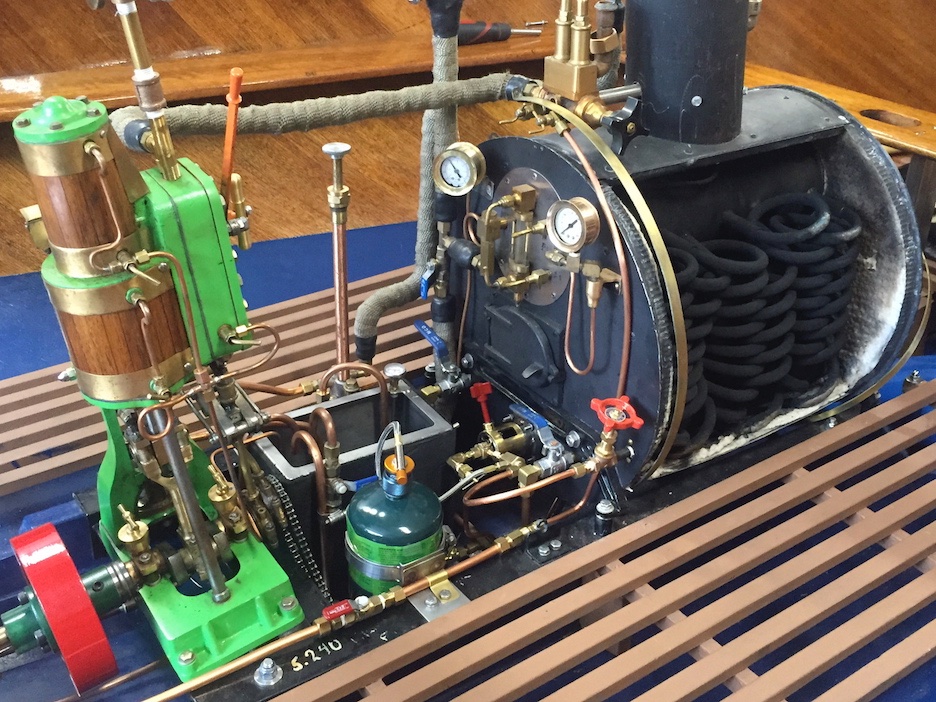

Looking at your Blackstaffe boiler design compared to my original boiler built in the 1960s by Cliff Blackstaffe, I see that your stack is mounted behind the steam dome.
That implies gases moving from the original end-mounted oil burner(?) lengthwise through the circulation tubes, and then up the stack.
The new gas burners installed don't appear to allow that lengthwise circulation.
My boiler actually has the smokestack surrounding the steam dome providing extra heating as the gases exit the main boiler. The original kerosene/diesel fuel burner is at one end, hitting a central metal target plate just above the grate location, and distributing the heat centrally and outward though the heating surfaces.
Below is a picture of the original 1960s Blackstaffe boiler, used to fabricate a new identical replacement unit.
You can see how a central flame target would distribute heat away from the down-comer tubes and around the side circulation coils, and then exhaust up along the steam dome, providing additional heating where the steam is drawn for the engine. And here is a picture of the new boiler mounted in the original casing, open for inspection and cleaning.
Note the small propane cylinder, used for cold fire-up until the steam oil-atomizer can be used. Not knowing the original fueling set up for your boiler, I can't offer additional understanding of the heating problems you are experiencing.
I'll keep watching your discussion.

I like the idea of a steam dome within the funnel; very ingenious! In service, the funnel on my boiler is at the for'd end. The plans I have indicate this was the original fit and the steam dome was added at a later date when the boiler was modified.
