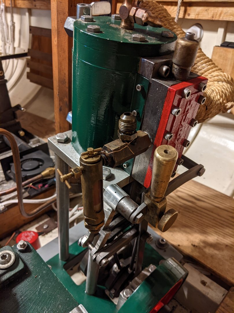

I expect that the 100 degrees mentioned is the amount the the author assumed would be lost in heating the cylinder block, but every engine is going to be different. Without oil, the engine relies on liquid water for lubrication, and any time the engine becomes dry, it's going to groan. So, with superheat and without oil, you are going to be on the hairy edge of having a chronically groaning engine.
That being said, you don't need much oil. My 6 hp compound has a mechanical lubricator that I can dial in to a precise amount of feed (basically turned as low as possible to prevent groaning when throttling back), and it uses about a tea spoon of oil in a full dry of running.
If it were me, I wouldn't remove the lubricator, just turn it off, and see if I can get away without oiling. If concerned about feeding too much oil, leave it turned off until the engine groans, then turn on the lubricator until the groaning stops then turn it off again.
Other than satisfying your curiosity, having a temperature gauge isn't needed, either the engine groans or it doesn't.

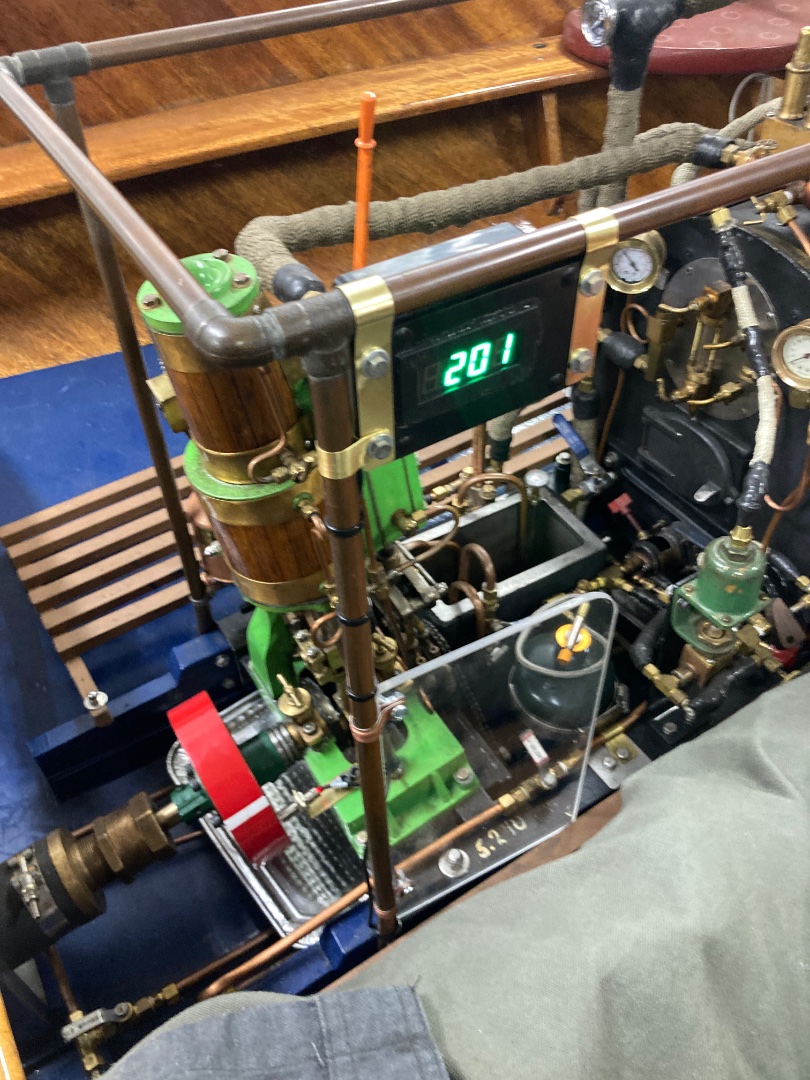

My 1960s vintage Blackstaffe steeple compound engine is condensate lubed, and I've never heard it groan.
Max operating pressure is close to 100 psi.
I must not be steaming it often enough...

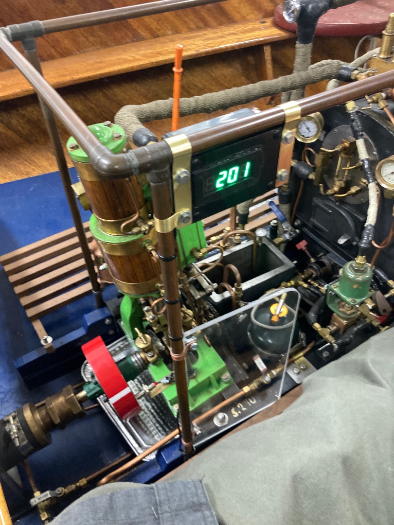

My 1960s vintage Blackstaff steeple compound engine is condensate lubed, and I've never heard it groan.
Otter's safety goes off at 180 psi; I hear the squeak/groan after running for a while at 125+ psi and then throttling down.

RNoe wrote: Sat Feb 24, 2024 4:42 pm My 1960s vintage Blackstaff steeple compound engine is condensate lubed, and I've never heard it groan.
Looks like your engine is using saturated steam? That and the low pressure could be the reason she doesn't groan. Raise the pressure and add some superheat and I'll bet $0.05 that she will be wanting some oil.

Yes. Higher pressure and super heat would definitely need some lube oil.
But then...
The hot well would need to be enlarged to accommodate oil removal,
and that requires new engine/boiler mounts,
and...
I may as well build a different launch.
I recognize that this steam launch has historic value as originally built.
I plan on resetting the safeties to 125psi from 100 psi, and see what that does for operation with some pressure "overhead."
However, the entire system was designed by Cliff Blackstaffe for 100 psi operation.
