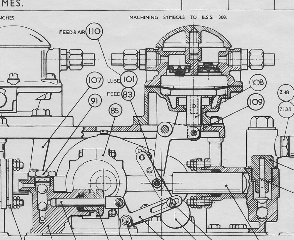

a cross-sectional view of the condensate, boiler feed, and cylinder oil pumps.
The work on the diaphragm pump is quite extensive. The first step is to remove the original lever drive and modify the remaining components to a greater or lesser extent.
This is the first time I've seen this design for the boiler feed pump valves. They are vertical mushroom valves, which I will implement using O-rings as sealing elements. Because the pressure acts on the valve mushrooms from above, springs to assist closing are unnecessary. Slightly higher demands are placed on the concentricity of the valve guide and the valve seat. It is important to provide the shaft with a wrench flat to prevent it from seizing.
The pumps are driven by a 2:1 reduction gear from the crankshaft of the steam engine. One condensate pump and one boiler feed pump are each driven by an eccentric mechanism.

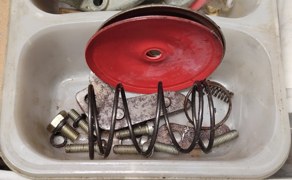

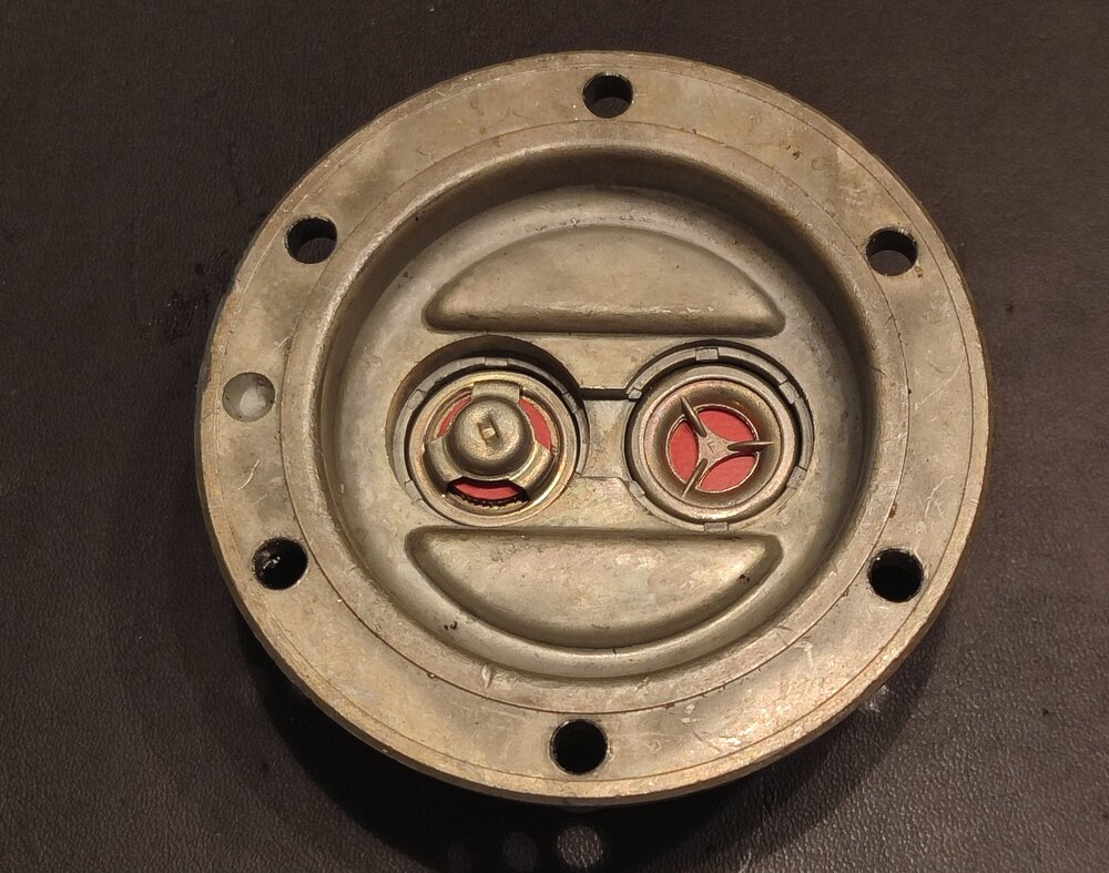

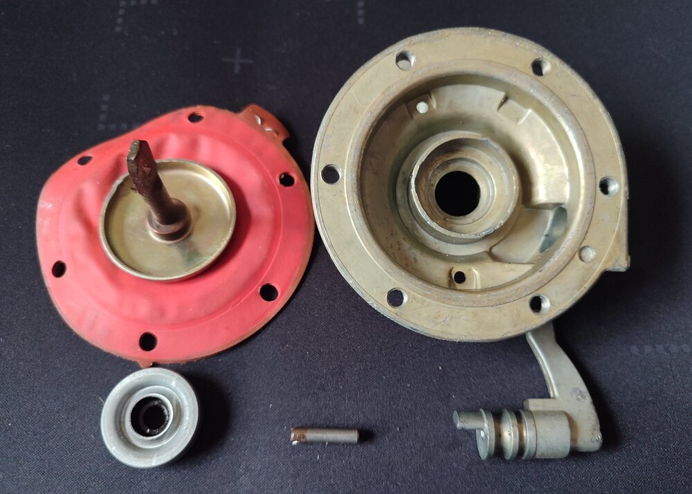

the tappet was guided in a combined seal/guide, which will be removed and replaced by a suitable guide bushing for the new diaphragm tappet. The lever for manual operation will be superfluous in the future and will be redesigned into a simple plug (the prongs will be removed) which is held by the original locking pin.
The top can be used without any alterations.
The individual parts of the drive, the lid seal and the sealing cover of the pressure valve chamber.
