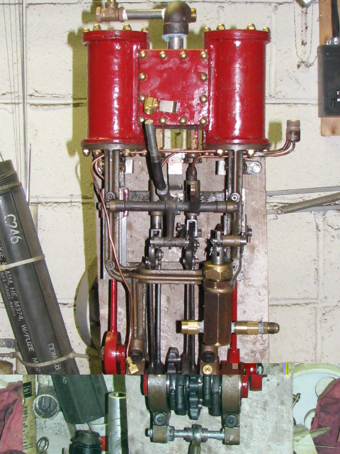

Here is the Locomobile engine.

Well, with an Engine like that you have three choices:
1. Build a side paddler. An engine of that design is ideal for side paddler use, as long as you mount it properly.
2. Modify the engine. Fabricate plate and bar stock frame to go around the lower section of the engine to hold it in a vertical position. this will make it suitable for rear prop use.
3. Both 1 and 2. Modify the engine for vertical mounting and use it in a sidepaddler. This will allow for a more compact layout.

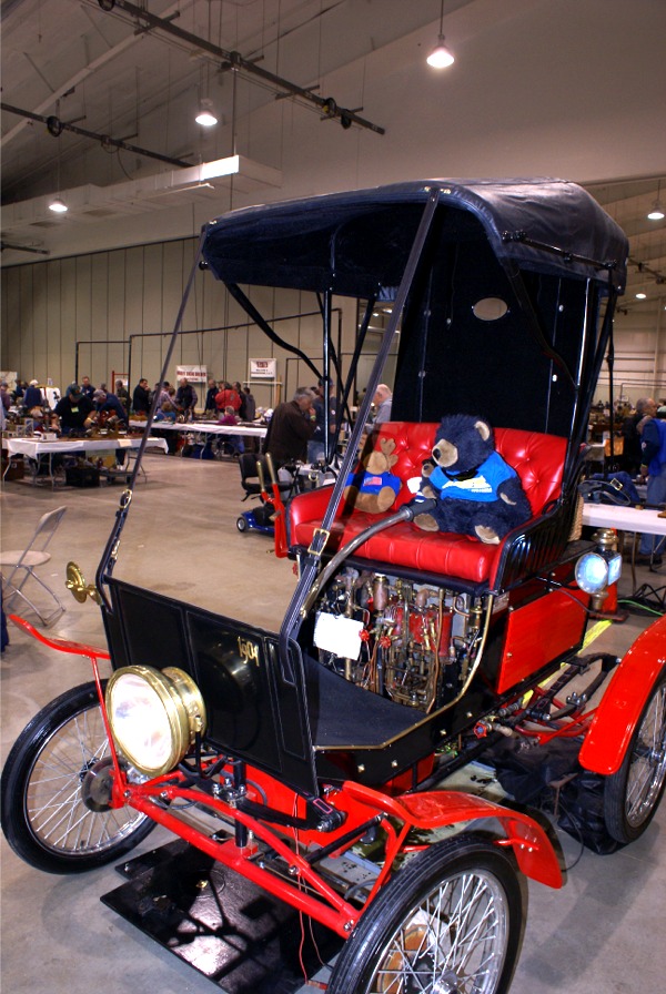

I have the same engine but its an earlier one 1899 to 1901 it has a brass lower end. The engine is about 10 hp so your going to need a large boiler. The other thing about this engine is the crank throws are 90 deg.from each other so you will need a flywheel for it to run smooth, that will be a problem mounting a flywheel on a car engine. Depending on the size of the boat, it could be overkill. It could be used in a boat in the vertical position with a chain to the shaft, but you will have to make a mounting plate which will have to be fabricated and welded. The engine may be worth more money if was sold for a car. Then you could buy a marine engine that's ready to be mounted. It it was used on a wheeler then most likely it would run without a flywheel.I have run this engine on compressed air about 60 psi and it jumps all over the place with out a flywheel. By the way the engine that I have is in a Locomobile.
- locomobile
- car complete.jpg (185.21 KiB) Viewed 18749 times
- locomobile engine
- IMG_0006.jpg (227.52 KiB) Viewed 18749 times
