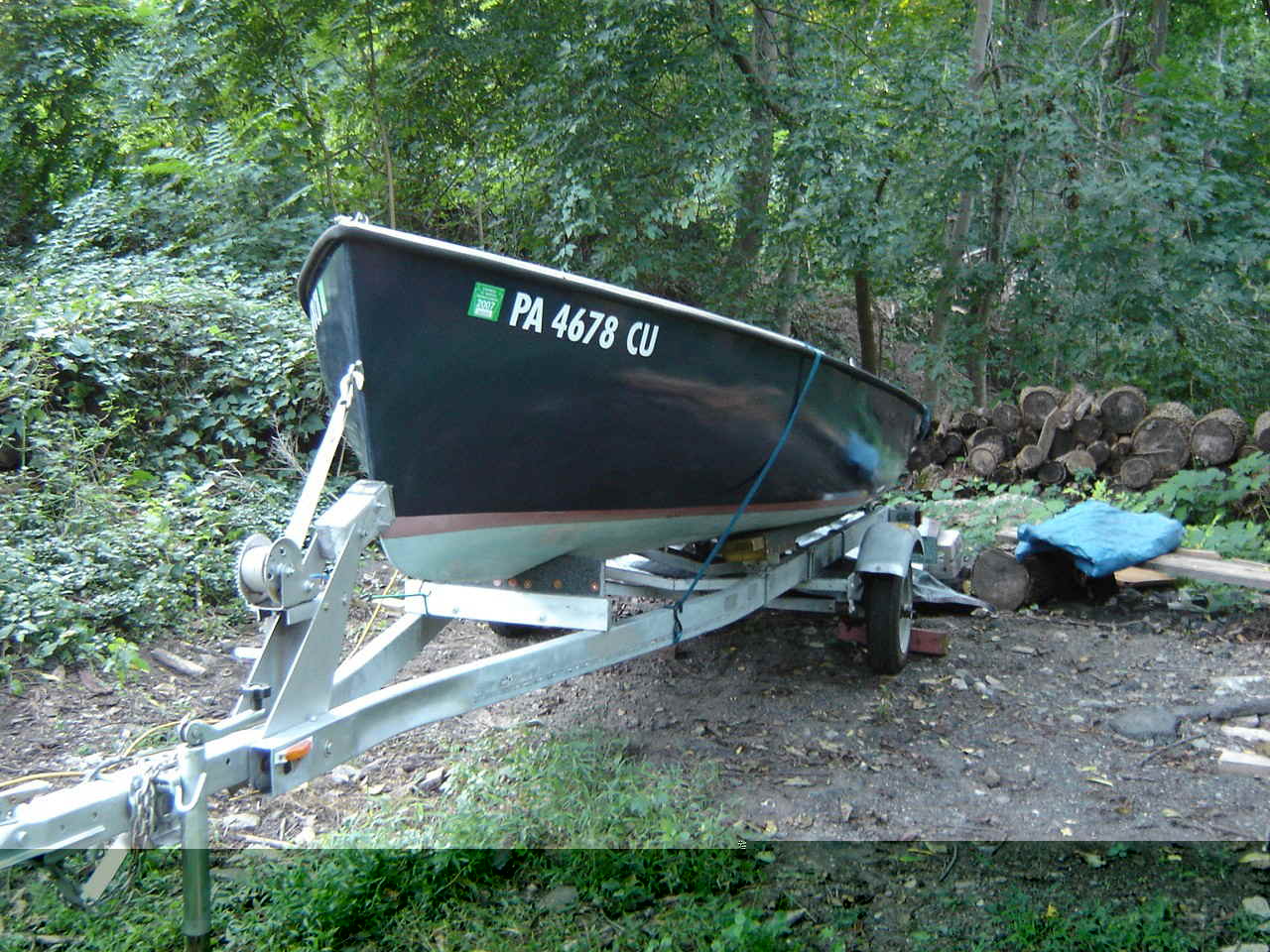

The most economical way to build a steam launch is to start with a good fiberglass sailboat hull. Get one with a centerboard well, not a deep keel boat. These hulls, with a trailer, go for very low prices on e-bay, if the boat has a broken mast or bad sails. For example, I paid $107 for a 14 ft O'day Javelin, with trailer, and broken mast, no sails.

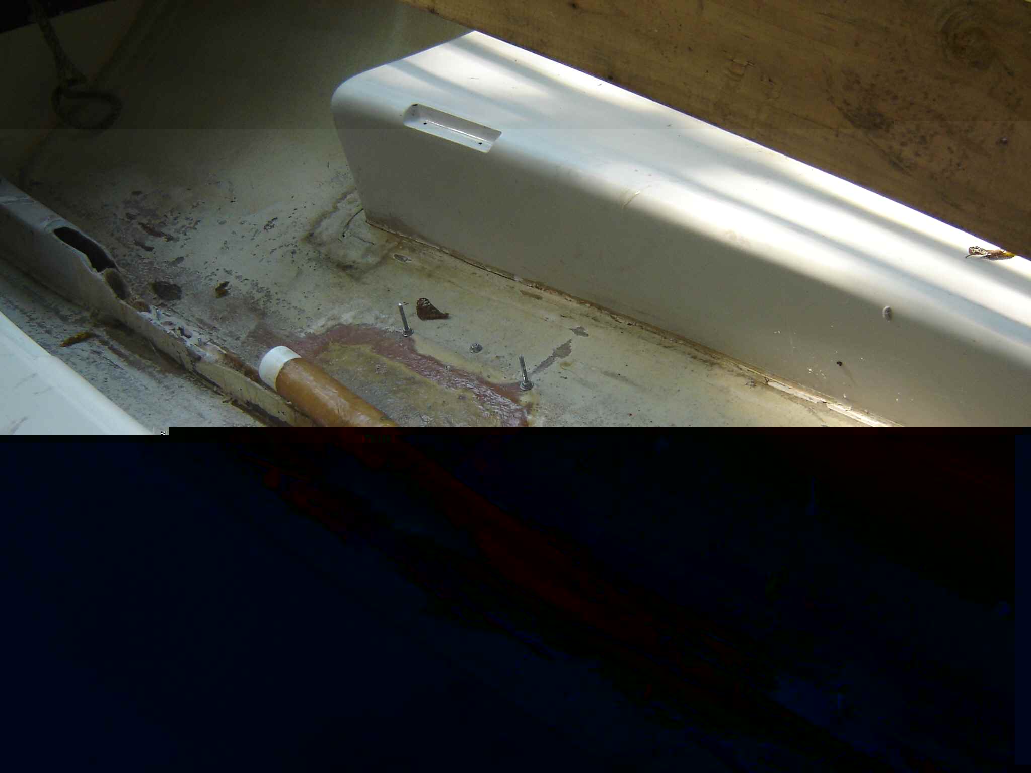

Next step is to cut the centerboard well out of the boat hull, I used an ordinary 7 inch circular saw, making cuts about 1 inch on each side of the centerboard well. Remove the centerboard well, and fiberglass into the hull a propeller shaft tube, I used 2 inch PVC pipe, and an ordinary automotive fiberglass repair kit.

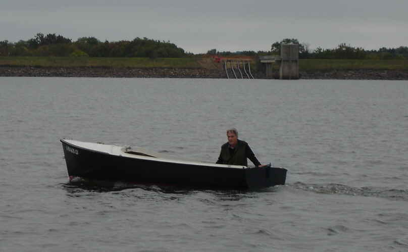

This boat was made into an inboard electric launch, for the outings with the steamboat group while my bigger steamer was being built. It has served well for 5 years now, having traveled up and down the Delaware River in Pennsylvania several times, in addition to the local lakes, etc. Usually 4 adults go out on this boat, and it goes at the typical steam launch speed of about 5 MPH. There is a full explanation of this project at http://groups.yahoo.com/group/electricboats/
Of course, you will be installing a steam propulsion unit rather than electric, but the typical sailboat hulls are ideal for this service and power level. They available in very good condition for a small fraction of the cost to build your own.

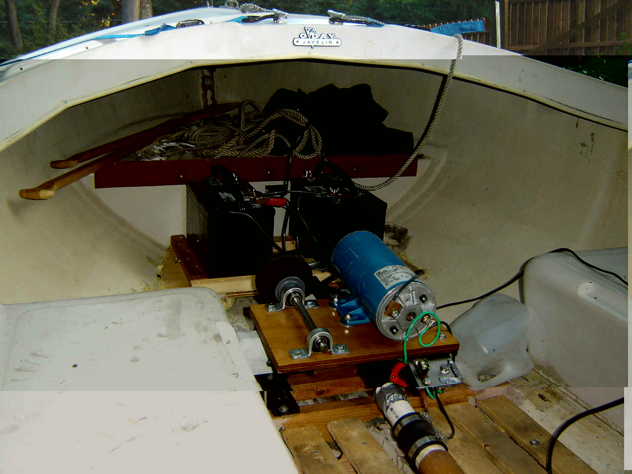

A few more pictures of the Javelin conversion process. The key to getting reasonable performance with low power is to turn a big prop at low speed. If you pick out a canidate hull to build your steamboat, I will do the calculations for speed, horsepower, propeller size, etc.
- Cruising on a local lake

- Electric drive setup, 1750 RPM motor, belt drive to prop shaft
- Jav-Motor444.jpg (98.53 KiB) Viewed 15892 times
- Propeller shaft fiberglassed into hull
- SHAFT TUBE.jpg (141.99 KiB) Viewed 15892 times
