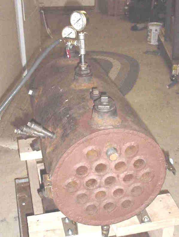

As far as the stainless steel issue goes, I only mention it because the ASME Code is quite clear in its directive prohibiting its use in the wetted parts of the boiler. I believe the problem is worse where there are high stresses, and, while the pressures we use are generally low, stress can come from bending of tubes due to thermal expansion, tubing hanger attachments (plenty of them in a large coil) or numerous other causes. I think most steamboaters don’t have the technical skills to address these issues.
I have actually seen stainless steel which developed corrosion pits about 1/2 inch deep in 30 days time, on a poorly specified sea water intake system. Carbon steel is much more predictable.
Carbon steel does not have the stress-corrosion issue, and is a very ductile material, and hence forgiving with respect to many stress related issues. Rust is a potential problem, but a few simple layup practices can virtually eliminate the rust issues for many years. My boiler for a domestic heat power module was built in 1979, and I recently hydro-tested it at 550 PSI. It uses 1-1/2 inch boiler tubes, 0.125 wall. The shell is 12 inch Sch 20 pipe (0.25 inch wall).
On e-bay, you can buy a new Hot Box, with casing, a 350,000 BTU oil burner, fuel tank, mounted on a metal dolly with wheels, with automatic controls and connections for $1400. I know the burner itself is a $500 plus wholesale item, so I would think the coil alone would be less than $500 probably. It is always easy to find someone who will make something for a high price, and they are often being fair, because they are not experienced in that specific type of work, and don’t want to take a risk of losing money on a small order. If you find the people who manufacture the coils for hot boxes, the prices will be much lower I am sure.
Carbon steel boiler tubes are the norm for typical low pressure boilers. ASME SA-178A boiler tubes are readily available, the smallest my supplier has is 3/4 inch OD x 0.085 wall. 3/4”, 1”, 1-1/4” , 1-1/2” , 2” , 3” and 4” boiler tubes are the standard inventory at Anderson Tube Inc., with wall thickness typically ranging from 0.095” to 0.135”.
Smaller tubing in carbon steel is available as heat exchanger and hydraulic tubing, ranging from 1/16” OD and up.
All types of tubing will typically have a fine finish on the OD and ID, which is what you need to use Swagelok fittings. Pipe usually has a rough mill finish on the ID and OD, so the surfaces would have to be cleaned up with emery paper before using Swagelok fittings.
