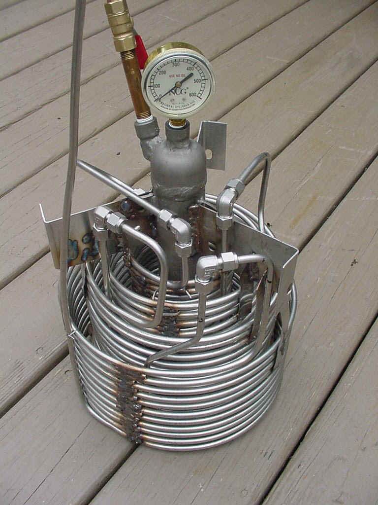

Flash Boiler of 1/4 OD tubing

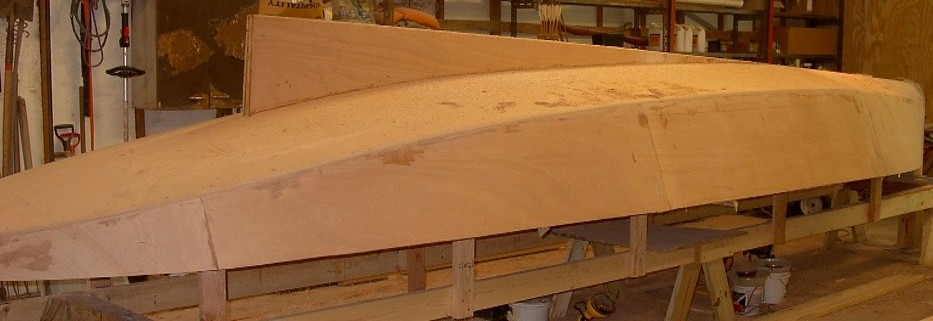

Okay, let's try this ... From several weeks ago when I was still rough fairing - starboard quarter, aft.
Starboard Aft Quarter reduced.jpg (111.53 KiB) Viewed 12534 times

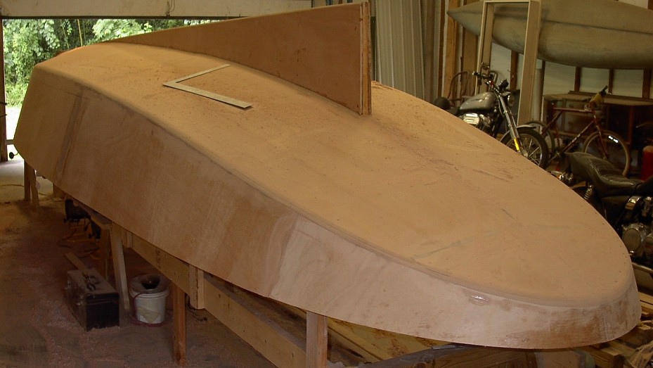

Profile forward ...
Profile Forward reduced.jpg (75.53 KiB) Viewed 12534 times

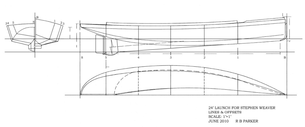

Okay, took a little while to convert the lines from a ledger-size pdf file ... Writing's a little blurry, but you get the idea ...

Nice hull building, looks like it will do well. I also see motorcycles in the background, some of us have had a few. Do you know Kelly Andersen of the Strasburg RR?

Hi Steve, welcome to the forum and thanks for posting - a very nice hull and a good size too. How long has it taken? In due course, please do post some pics of boring for the stern tube as this is a tricky part of building a boat for most of us. Looks as though your designer has been clever and drawn so that the bore is at right angles to the end face of the keel. Best wishes for your project, John in Scotland
