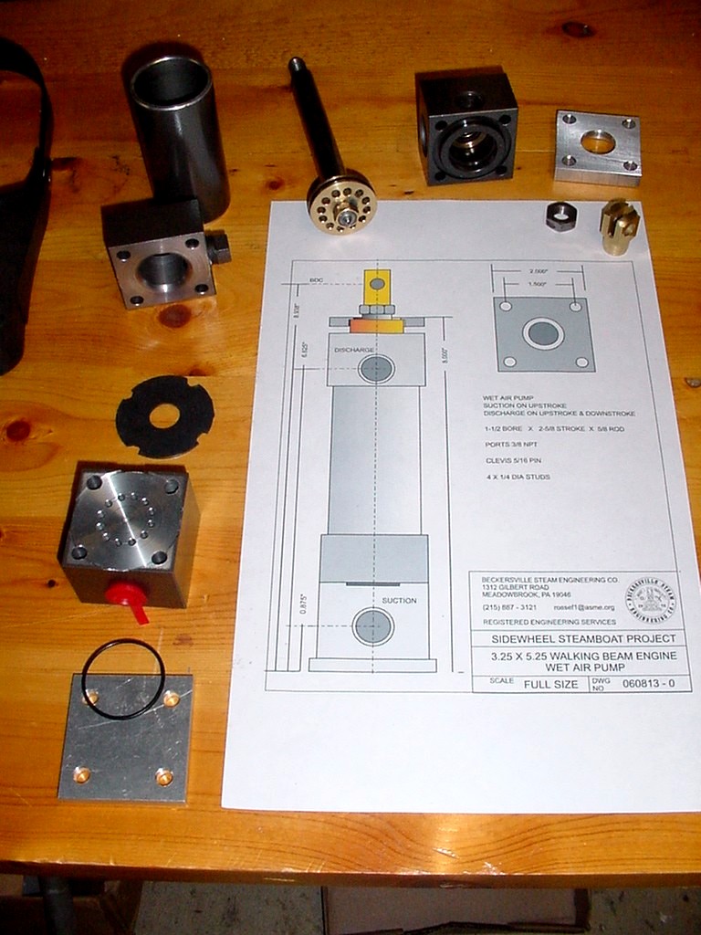

A wet vacuum pump will remove condensate and maintain vacuum exhaust for better economy. The pump running at engine speed should have about 1/2 the bore, and 1/2 the stroke of the main engine's cylinder. With reasonable packings this will handle air leakage and easily pump out all the condensate.
I made mine from a commercial pneumatic cylinder, much less machining and better quality bore, gland, and piston rod finish than I can make in the home shop. I will send details of internals once you decide what cylinder to buy on e-bay.
Wet Air Pump made from Pneumatic Cylinder
