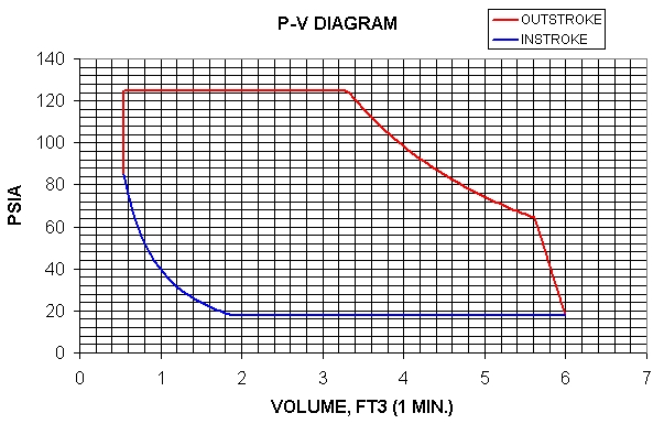

The equations presented assume a nearly perfect steam engine with no clearance volume. Real engines have clearance volume ranging anywhere from about 5% and up. Analysis of the clearance volume, plus the point where the valve gear starts compression on the exhaust stroke are both very relevant to the analysis of MEP
Attached PV diagram shows a diagram with clearance volume, and partial compression in the exhaust stroke.
- Engine PV diagram with compression and clearance volume.
- PV DIAG.jpg (183.81 KiB) Viewed 16724 times
