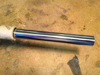

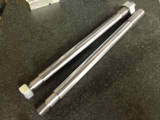

Just finished the piston rods for the York compound and thought I'd share some pics.
The material called for in the prints is Monel but due to the difficulty machining Monel and the expense I decided to substitute 1045 CPO rod. The CPO designates chrome plated only. This is the rod used in hydraulic cylinder service but supplied unhardened. I was expecting the chrome to make for difficult machining. I could tell that there was some resistance when breaking through the surface but otherwise the machining was no worse than with standard 1045 steel. This material can be somewhat difficult to find but should fit the service conditions very well.

John York is the only person who can answer that question, I didn't ask, as after doing a bit of searching for ground Monel rod stock (couldn't find) had intended to use a substitute for Monel as the piston rods.
I prefer to purchase my tolerance and finish where possible so I had narrowed down my choices to ground & chrome plated hardened 1045/1050 rod or precision ground stainless rod. Both have issues. Stainless, while corrosion resistant tends to gall easily and can be abrasive to the glands so was lower on the list. The hardened chrome rod is of course, hard and not easliy machinable without annealing. A process that while I could do, didn't want to try in fear of damaging the chrome and in due to the lack of control over the process when using a torch. Also, had the option of sending unfinished steel out to be ground and plated but that is what I was trying to avoid with the Monel.
In my searching I ran accross a reference to CPO rod stock and after even more searching found a source on-line. This material can be a bit difficult to source but most hyrdraulic cylinder repair shops should carry it. I used TeamTube and was able to purchase a 4' rod for a pretty decent price.

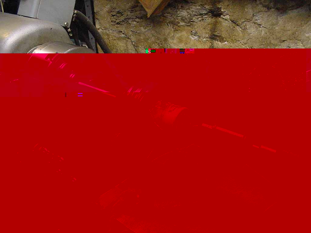

Ground and chrome plated piston rods are about the best for both corrosion resistance and long packing life. Monel has the same advantages, but costs a small fortune. Ground steel rods can work ok, but some of us use no oil in the engine, so rust would be a problem for these engines.
I get ready made hard chromed and ground rods from surplus pneumatic and hydraulic cylinders. A cylinder on e-bay can be found for only a few dollars. On the Margared S. walking beam engine, the 3-1/4 inch diameter piston came from a 3000 psi hydraulic cylinder, with an attached 1-1/4 diameter hard chrome rod. The picture below shows the machining setup which was used to separate the rod from the piston. I did a similar job on a 250 psi pneumatic cylinder piston and rod, only that unit had a 5/8 diameter hard chrome rod, which is what I mated to the 3-1/4 piston. In the second season with the 5/8 diameter chromed piston rod, and packing is holding up excellent, have only tightened the packing slightly one time, and there is virtually no leak in the packing. With good alignment to the crosshead slippers, this packing may last for several years.
The 1-1/4 inch diameter rod makes an ideal plunger for the manual feed pump.
- 3-1/4 piston & 1-1/4 rod separation
- chromerodcut.jpg (89.93 KiB) Viewed 13864 times
