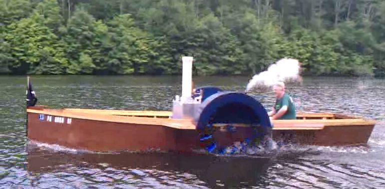

The engine is a little smaller than is typical for that size boat, but you will be able to do fine with your hull & No 10 engine. Cruising around at 4-5 MPH should be easily achievable. The sidewheeler Margaret S has less than one engine horsepower, weighs about 1800 pounds with passengers, and has the disadvantage of non-articulated paddle wheels, which are less efficient than a propeller. Although not fast, the sidewheeler keeps up with the other steamboats when we are not racing, and provides pleasurable cruising. The paddle boxes are like large "windcatchers", and steaming against the wind slows the boat somewhat, but I have had no problems with being blown off course.
