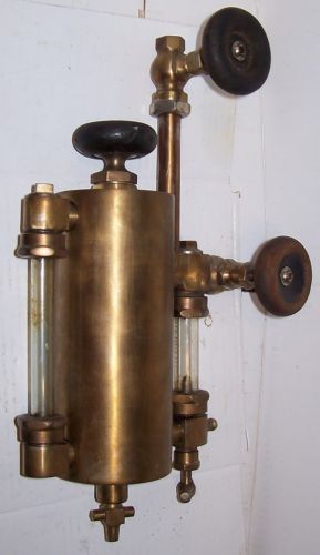

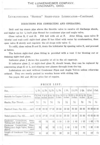

If someone can give me more detail on how this modle works I would appreciate it. It is the "senior" model that does not have the condensation bulb on it. I am confused as I read the operating insturctions, they seem to leave out the step of turning on the main steam valve.
I am also not clear on how the oil feed is regulated from the needle valve in the bottom of the oil sight glass. I have posted a pic of the oiler and also the instructions.

There is meant to be a condenser pipe and valve from the steam inlet that connects to the vertical pipe. One neat installation I saw had a nice coil of 4 0r 5 turns of copper pipe as the condenser all polished and shiny. This valve is used to isolate the lubricator. The valve at the bottom of the oil sight glass adjusts the oil. Big locomotive practice was 1 drop every 2 minutes !!
(You don't need a lot of oil) What you can't see is that inside the oil reservoir there is an internal pipe leading from the oil valve to the top of the reservoir. Oil floats on the condensed water. The oil comes out the second connection.
It is interesting that the instructions say to take the steam off above the throttle valve. This means that if the steam stop valve at the boiler is open and the engine stopped with closed throttle, the lubricator will keep on dripping. I guess the throttle is usually to close to the engine and there is usually no decent run of vertical pipe.
By the way Ron's lubricator is a "Junior" I think and has only one connection to the steam pipe
