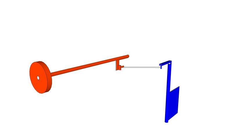

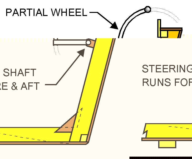

The sidewheeler Margaret S has a 1:1 ratio on the rudder, turning the wheel 90 degrees swings the rudders 90 degrees. I made it this way so the steering shaft runs fore & aft, I get confused with the wheel shaft oriented athwartships. The wheel itself is only a partial wheel, so the shaft can run close to the hull sheer, and not get into the way of other machinery on a small boat. I use the same setup on my 14 ft electric boat, and both work well with the 1:1 ratio. I use ordinary Heim joints in the linkage, no cables or ropes to deal with. This gives virtually no free-play in the linkages.
The steering shaft runs in wood bearings, which can be pinched to tighten them up, so the rudder position stays in place if the pilot leaves go of the wheel.
- Rudder - Wheel Arrangement with 2 Heim Joints (Ball Rod Ends)
- RUD mech.jpg (13.29 KiB) Viewed 14900 times
- Hull section looking forward
- RUD WHEEL.jpg (54.03 KiB) Viewed 14900 times
