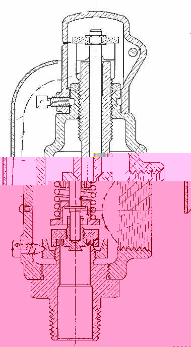

Steam Safety Valves are typically arranged with a spring forcing the valve disc against its seat, when the force of steam pressure acting on the valve disc area exceeds the spring force, the valve unseats and begins to relieve steam.
Steam Safety Valves usually have a “Huddling Chamber” concentric to the disc and seat, which collects extra upward force when the valve starts to lift off of its seat. The steam released into the huddling chamber acts on the additional area of the huddling chamber, and the valve “pops” open. Only after steam pressure is significantly reduced can the spring force close the valve, so when steam pressure is reduced to a value lower than the set pressure, the valve reseats and “pops” shut. The reduction of pressure before the valve re-seats is called “blowdown”, not to be confused with the blowdown process of intentionally releasing water from the boiler to reduce sludge and dissolved solids.
This action can (and does) work regardless of whether the seat is tapered or flat.
As to testing the relief valve, simply operating the manual valve stem lifting handle is not a proper test. Steam pressure should be brought up to the valve pressure setpoint, and the safety valve should lift and relieve pressure. This test should be conducted annually, although I usually test the safety valve a couple of times each season. The valve must be adjusted so that the Maximum Allowable Working Pressure (MAWP) is not exceeded before the valve lifts. These are requirements according to the boiler code, and are mandatory requirements.

- Safety Valve with Huddling Chamber
- srv.jpg (45.15 KiB) Viewed 12416 times
