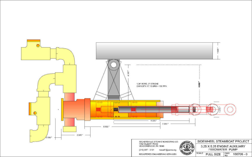

The pump should have all wetted parts of corrosion resisting materials, brass & bronze, or stainless as Bart recommends. It is recommended that the water circuit from the water source (tank, lake, etc) to the pump also be corrosion resisting materials, automotive radiator hose is what I use, with a strainer just before the pump suctions. This will minimize pump trouble with hung-up check valves, etc. The discharge piping can be any pipe suitable for the temperature/pressure, common steel would be good.
The manual feedwater pump for the Margaret S. was made from standard brass pipe nipples and standard brass screwed fittings. It is fairly large, with the pump cylinder of 1-1/4 inch pipe, and the inlet/outlet check valves are standard 1/2 inch swing check valves. Although rather large, (200 PPH water flow at 15 strokes per minute) it has given good service so far, and was built in less than a day, due to using only standard screwed pipe fittings. A short piece of 1-1/2 inch boiler tube forms the manual handle, and it works with reasonable effort at about 85 PSI in the boiler. If I pump to higher boiler pressure I would make a wood extension handle to insert into the 1-1/2 inch tube handle.
A brass plate is silver soldered onto the suction/discharge head for mounting to the steel frame that has the hand lever attached, alternately the pump barrel could have been simply attached to the frame with ordinary "U" bolts. The connecting rods are 1" x 3/16 inch flat bars, and the pivots are simple hardware store shaft collars welded to the flat bars, or ordinary steel nuts & bolts used as pivots. These parts are not detailed on the attached sketch, which shows only to basic pump cylinder / piston & Check valve arrangement.
The only lathe machining required was to cut down a brass reducing bushing to 1.35 inch OD, and machine two grooves on the piston to accept standard O-Rings. The store bought brass pipe nipple that makes up the pump cylinder has a finish that is good enough for pump duty with no further work. Making everything else was with a hacksaw, a common portable drill, and some MIG welding.
