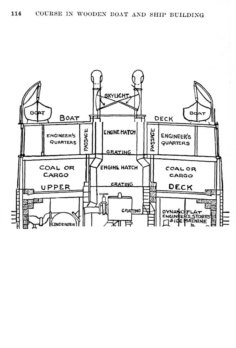

The attached picture is an engine room section from a WWI USA wooden freighter, 282 feet long, with several 14 inch x 14 inch wood engine bearers shown.
