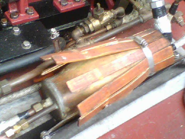

On the discharge side of the pump, since there is a valve between the pump discharge and the boiler, you may have to have a relief valve to protect the piping between the pump discharge and the boiler valve. This depends on the pressure capability of the pump, and most small reciprocating pumps can produce outrageous pressures if the discharge is blocked shut from the boiler. There must be no valve between the pump discharge and the relief valve.
On my steam setup, the engine driven pump could produce well over 5000 PSI if there was no relief valve, so I have one on that piping. My manual pump cannot produce so much pressure, if I stand on the pump handle, only about 250 PSI is produced, and the piping is good for well over 500 PSI, so this pump discharge does not need a relief valve.
Throttling shut the feed pump suction valve would also reduce feed flow to the boiler, but that would most probably cause problems with the pump, should not be done.
- Feedwater Heater Destroyed by Excess Pressure, No Relief Valve was Installed
