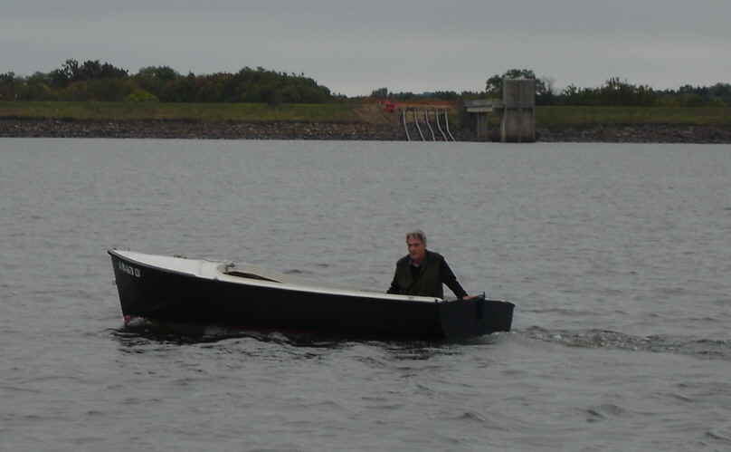

You might want to consider converting a small planing sailboat hull into a steamer. The cost is very low if you get one with a broken mast or bad sails.
Conversion to a propeller driven steamboat hull is very easy. Having recently built a 20 ft plywood steamer hull, and also done the fiberglass sailboat hull conversion, I would say the Fiberglass Hull conversion cost is about 5% of the Plywood Hull, and the Labor Cost is also at about 5% of the plywood build.
I built an all electric inboard from a fiberglass sailboat hull, to run around with the steamboats in my area while building a plywood sidewheeler. The boat has held up well for 6 years now, and is suited for a small steam plant. I intend to make this little electric into a fast steamer this summer.
A good summary of the conversion process is outlined on the Yahoo Group “Electricboats” under “Files”, “Building a Javelin Electric.pdf”
- ElectricBoatSmall.jpg (21.43 KiB) Viewed 13419 times

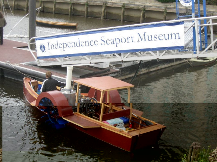

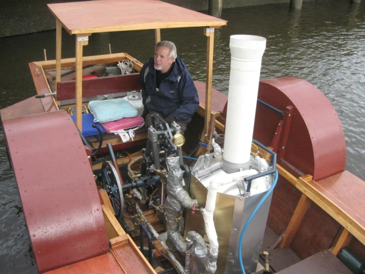

Found a decent picture of the sidewheeler with its "fold down" canopy. The support colums are pivoted on the gunwales, so the entire canopy lowers onto the stern of the boat, becomes like a hatch cover over the entire stern opening. With the canopy down the operator seat is usable.
The canopy is 1/4 inch plywood, with 3/4 x 2 inch perimeter framing, and ribs 16 inches on center, screwed and glued. One can stand on this when the canopy is down, but it certianly won't take any serious dancing!
There is a similar forward canopy, but I have not yet gotten the colums and pivots in place. I need to get a "round tuit". I do however use the forward canopy when trailering, and stow it in the trailermobile before launching.
