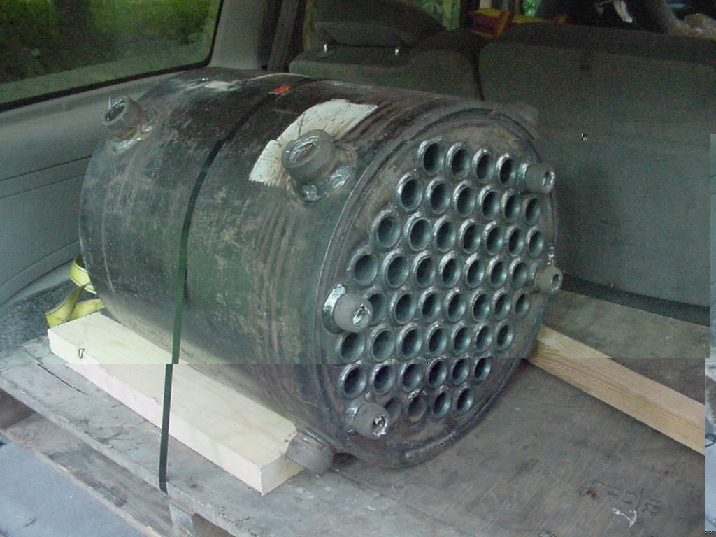

- ASME Code Boiler Shell for Steam Launch
- Boiler ASME M.jpg (141.55 KiB) Viewed 7284 times
