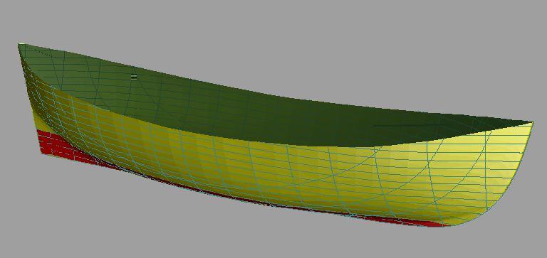

Re: Draft
"I guess the only way to figure out what she draws is to put her in the water ?"
One can use freeware, "Deftship" to draw up the boat hull and then know all about its hydrodynamics including draft. That may be something you may consider, if you like that sort of thing. I do that kind of stuff for fun (measure a hull and work it up on Deftship), but it does take some time, depending on your inclination to computer work. You may also be able to get the lines for the hull off the innernet, or get something very similar from the Deftship library.
Free model on Deftship Website
