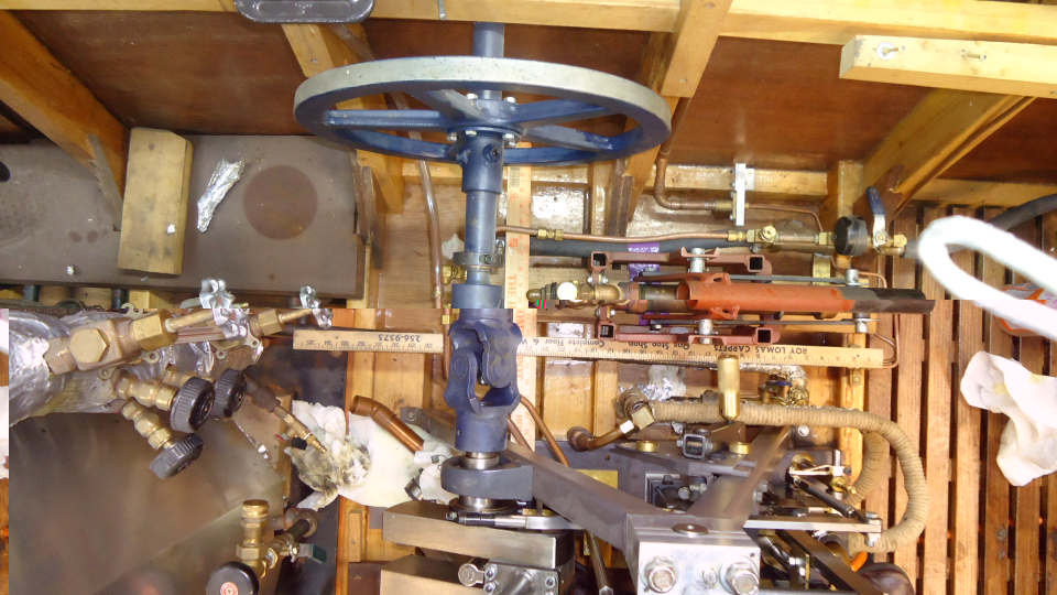

9. Where in the feedwater circuit should I have a pressure relief valve ? ANS: on the pump discharge line, with no isolation valve between the relief valve and the pump discharge. In general, you need relief protection for any piping or pressure retaining component that could be exposed to pressures exceeding the design pressure of the piping or component. That usually means a feed pump relief valve if reciprocating pumps are used, and a boiler safety valve. If an economizer can be isolated from the protection afforded by the main boiler safety valve, then this section of piping needs its own relief valve, with no isolation valve capable of removing the protection of relief. If your exhaust piping can be isolated from atmospheric vent, then this piping would also need a relief valve, again with no intervening isolation valve.
I use 1/4 inch OD copper tubing for piping drains and cylinder drains, also for my bilge eductor, which has 5/8 OD copper discharge piping, 3/4 copper suction.
- piping.jpg (86.13 KiB) Viewed 7160 times
