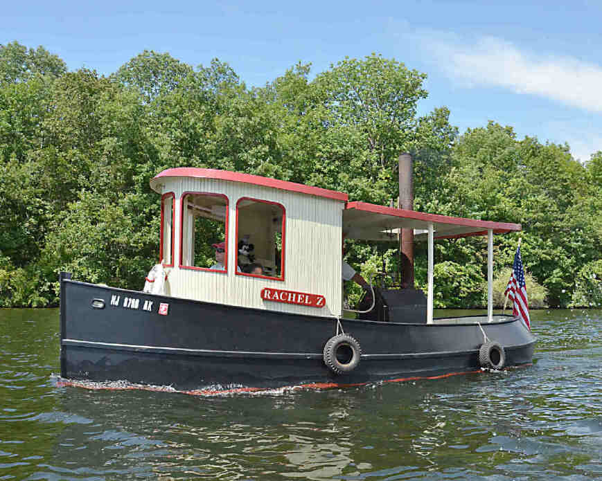

Re: Possible steamboat?
This TUG looks very similar to the boat put together by Charlie Roth last year. Charlie trailers it all over the east coast, and the boat seems to have lots of space, although I have not been onboard yet. It is flat bottomed, and quite beamy.
- Rachel Z SS.jpg (75.87 KiB) Viewed 9252 times
Fred,
That is a fine looking tug. It does look like the plan above for Glen-L. If I remember correctly, the Rachel Z is about 18 foot.
