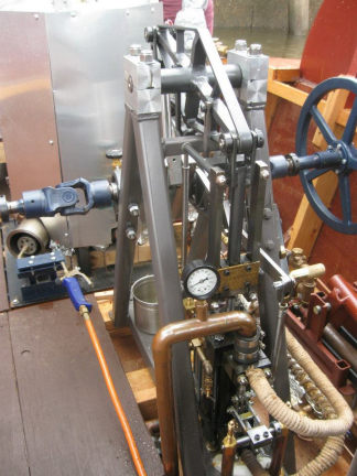

I have thought of putting a foot pedal which must be pushed down in order to have fuel flow, I think there was similar type safety controls on locomotives? If the engineer does not push the pedal down, the fire goes to pilot flame only. Of course this will only work for oil/gas firing. The propane weed burner that I use to fire the boiler has a spring return hand lever to give high fire, and this could easily be adapted to this service.
If possible some basic training for a willing passenger might save the day, although many passengers find the steam plant way too complicated to deal with. At steam meets there is often a passenger who is a steam enthusiast, and that person should at least be informed of the locations of basic system valves, so they could take over in a pinch.
- Burner Hand Lever, (BLUE, on Left) not currently used.
- SW Burner.jpg (40.52 KiB) Viewed 13450 times
