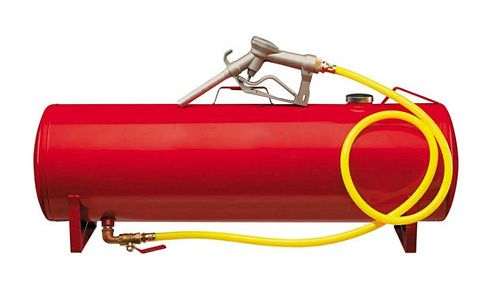

I am assuming you want a pressurized fuel tank for a vaporizing burner (air pressure over the oil forces oil to the vaporizer), similar to a Stanley Steam Automobile setup. Two options: 1. a portable compressed air tank sold at automobile supply houses to fill tires without use of a pump, Harbor Freight, etc, about $30USD. These hold about 3 +/- gallons, and are designed for 125 PSI maximum pressure. 2. A truck compressed air tank (for air brakes) which may be available surplus, I found new ones for $15USD each, 165 PSI design, larger and way more connections than the tire filling air tanks.
You will probably need to have a filling nozzle welded to the tank, use a 1-1/4 inch Schedule 80 pipe half coupling, and have the welding done by a proper welder. Hydrostatic test at 2x maximum working pressure, and have a relief valve set at or below the tank's MAWP. Usually a top connection to the fuel line is prudent, with an internal dip tube down to about 1/2 inch above the tank bottom.
The later model Stanley vaporizing burner system used an unpressurized main fuel tank, with a small (about 1 quart) tank having air over the oil. If you want this type of setup, you can get an auxiliary die-sel fuel tank sold for mounting in the back of a pickup truck. I bought one for water in my steamboat, it is about 10 inches in diameter, 40 inches long, and holds 15 gallons. It comes with mounting feet, a standard sized fill nozzle, with outlet ball valve and fuel hose, etc. $90 USD
A pressurized fuel tank should be properly tested annually, as big fuel leaks in a boat could have serious consequences.
Re: oil burners
A tank
