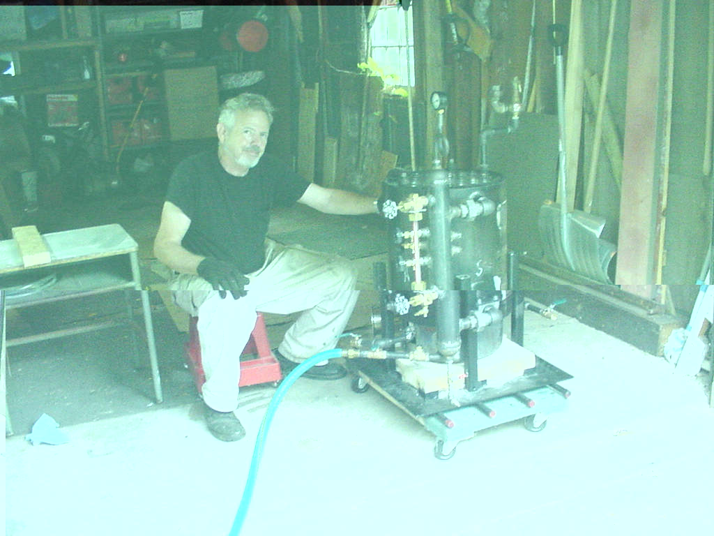

- VFT with Water Column
- WARMING BOILER.jpg (99.77 KiB) Viewed 5036 times

Re: Sight glass
I made that column from a piece of 2-1/2 inch Schedule 40 Pipe, and wanted to be parallel to the Top and Bottom shell side connections on the boiler, that is why it is so long at 20 inches, but I have room for it. I also used street elbows to attach the water column, and I got good alignment by having the elbows and unions in place while I tack welded the column connections onto the column. All attachments are SA-105 3000 pound Thread-O-Lets. Using Schedule 80 Half Couplings would have probably been OK, but the ASME Code does not allow that. The overall cost difference is minor, so I would recommend you use the Thread-O-Lets.
All piping attached to the boiler is Schedule 80, and all Screwed Fittings are 300 pound Malliable Iron (Rated for 300 PSI Steam).

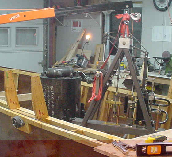

The second photo shows the separator on top of the boiler before assembly. A piece of 3 inch Schedule 40 Pipe, 12 inches long, with butt welded ends
- Boiler Water Column Connections
- Engine-BoilerPlacement01.jpg (123.64 KiB) Viewed 5015 times
- 3in x 12in Separator on Tubesheet
- Separator.jpg (35.88 KiB) Viewed 5015 times
