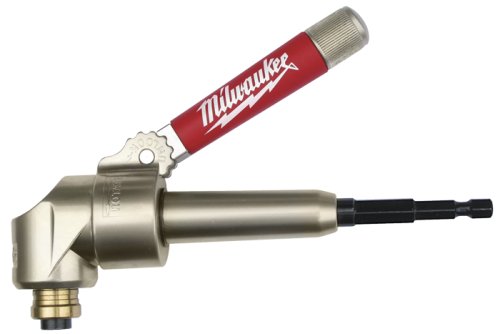

Cleaning up the burs on the inside of these drums should be possible using the driver that you will have to use to roll the tubes? Alternately, small right angle drives are sold for attachment to ordinary electric hand drills, and countersink bits are commonly sold for these drives. The Milwaukee model shown is 2 inches height, and takes standard 1/4 hexagonal tool bits. You could position the tool bit into the tube hole from one end of the drum, and force it against the hole with a wooden lever from the other end.

- milwaukee-49-22-8510-right-angle-drill-attachment-.jpg (15.63 KiB) Viewed 25667 times
