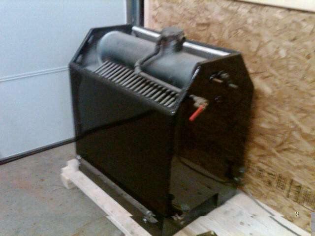

Thanks for the replies, I will let you know how it goes when the time comes. I have a couple of related questions. My boiler came with a rotating damper for the stack, but it is not installed. Should I install it ? If so, how high up on the stack is appropriate. I asume having it as close to the base of the stack as possible is a good idea but am not sure.
My boiler does not have a door on the draft/cleanout opening that is opposite the main door. Do I need to add one, or possible an adjustable grate so I can control the amount of air getting to the fire ?

Yeah the way my boiler is set up, the fire door and ash door are on opposite sides..........not the way I would have preferred it but I bought rather than built it. I figure I will stay by the ash door and controls while my wife heaves wood in through the fire door......That way I wont get any soot on my ascot........ :D
So for the draft/cleanout door I should be looking at an actual door to close it off as opposed to a grill of some sort that slides to open varying amounts ?
Also, if I put the rotating damper in the stack will the help knock the fire down if things get too raucous ? I will try to post a picture of the stack damper later tonight so you can see what I am talking about. I have attached a picture of the boiler that shows the Ash/draft opening.

Re: What if you aren't a boy scout ?........................
My ash door has a heavy duty piano hinge on the top edge and has a fair amount of friction so it tends to stay where ever I leave it. And it is made of 1/8" steel. I find that most of the time it is open about an inch or two for full air supply. But it is nice to hear the fire pretty much stop when I slam it closed. I have a wedge shaped hunk of wood to keep it at one setting if there is a lot of boat motion that might make it close.
I don't know about trying to control the fire with a stack damper. I would worry about having smoke come out around the fire door and out through it when you were adding fuel with the damper closed or close to it. Most of the time I want all the draft I can get except when at the dock or stopping unexpectedly. I have a hunk of old plywood that I can flop on top of the stack if I need to slow the fire down more than I can by closing the draft. Haven't used it yet though.
