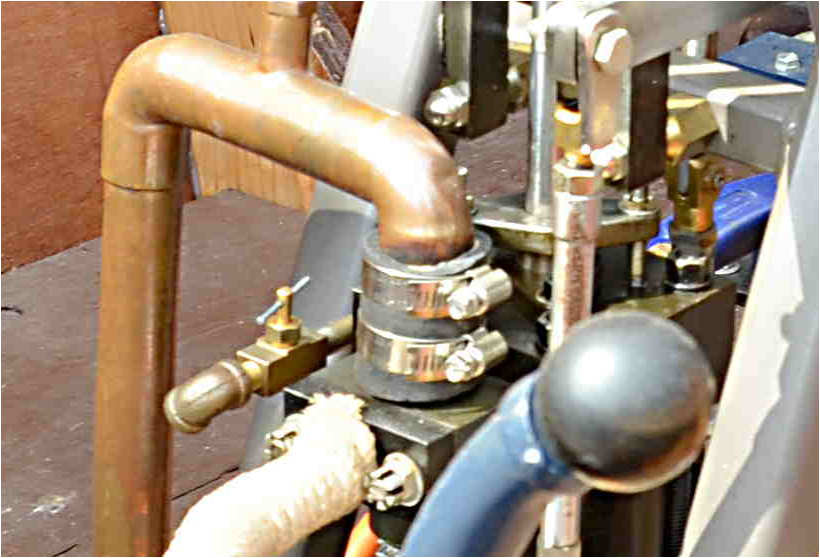

Re: Exhaust Temperature
Ron, perhaps I did not describe these connections well. The attached photo shows the use of automotive hose and stainless steel worm drive hose clamps for steam exhaust piping. I have these type connections at several locations throughout the exhaust system, and they are very reliable and leakproof for moderate pressure and for full vacuum. The exhaust piping here is 1 inch Type L Copper, all joints Sil-Brazed, except where I may want to take down a joint.
I hook up a refrigeration type vacuum pump to the engine exhaust piping to turn over and dry out the engine before layup. A sniffer tells me the only places where there are vacuum leaks is thru the valve stem packings.
Figured you didn't mean to have a gazillion short pieces of hose and hose clamps, but wanted to make sure that others also used a minimum of connections and fittings. As much as I could I used plumbing "sweep el" fittings to give the greatest radius on bends in order to reduce friction. For those not in the know, directional changes in piping can "steal" a lot of "work" due to resistance to fluid/gas flow and using sweep el fittings can reduce this.
