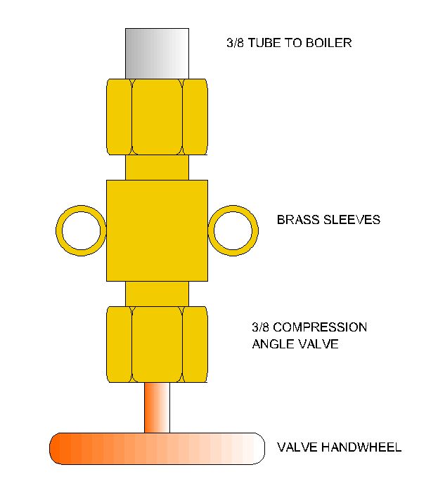

If you are in the Americas you can use 1/8 NPT x 1/4 Compression Brass Angle valves as try cocks, they cost abour $3 USD each. I often whip a piece of wood onto the metal handle so I won't get burned an can try without gloves. I also use these for cylinder drains, vents, etc.
I have also used similar 3/8 Compression x 3/8 Compression Brass Angle valves as the basis for model boiler gauge glass fittings. The glass fits into the tubing socket, and the compression eye is replaced with a few turns of Teflon pipe thread tape, it acts as packing for the glass, followed by the compression nut. For high pressure I have silver soldered two pieces of brass tubing as sleeves on each side of the valve bodies, and insert a two studs with nuts to keep the pressure from separating the two valves.
A gauge glass made this way has no safety ball checks, and does not meet Code, but I have been using them for over 40 years, with steam pressures up to 150 PSIG.

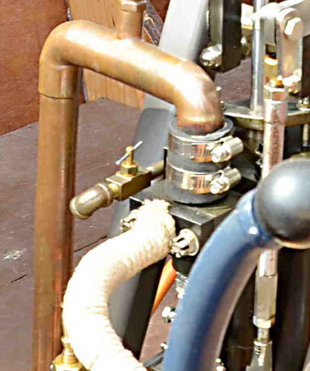

The quarter turn cocks offered by the vendors (Mcmaster, Essex, or Rappahannock) have always been rather stiff and I have never been able to turn them manually in steam service without a wrench.
The cocks with an ordinary screwed stem work well, but are much more expensive (Mcmaster= $55 each, Rappahannock = $22 each). I have three these on the boiler for water column try cocks.
All the other engine and piping drains on the sidewheeler are the brass "bar stock" type, either 1/8 NPT or compression fitting valve variety, at about $3 each. These have screwed stems, and packings, and are small enough to match our typical engine sizes.
