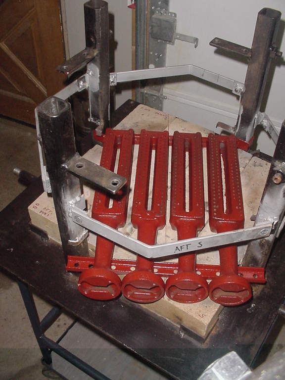

ANS: I bought the Bayou 210,000 BTU burner, but could only get about 50,000 BTU out of it before the flames lifted off the burner and it went out. Don’t know about their newer burner, but it looks about the same to me. I currently use four burners from a house heating boiler, at a little over 110,000 BTU/hr (352 burner holes, 1/8 inch diameter each) This setup brings my VFT Boiler up to 100 PSI in about 15-20 minutes. A watertube boiler typically has less metal and water than a firetube type, so heatup times could be shorter, assuming you have enough burner BTU capacity.

- 110,000 BTU Burners from Home Heating Boiler
- NewBurnS.jpg (66.41 KiB) Viewed 3749 times
