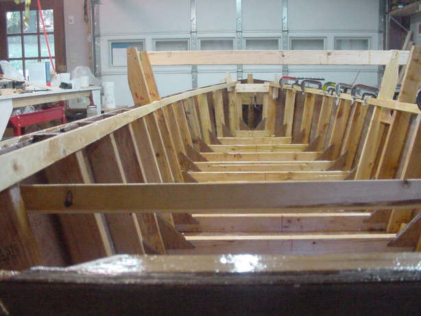

Things can progress rapidly, especially if you take some time off your day job. The attached photo is the Margaret S. just 5 days before the last steamboat meet of the season, and we were in the water steaming on that day. Keep your questions coming, several of us are willing to provide quick answers to your questions. Good luck!
- 5 Days to Go, No Boiler, No Engine, No Paddlewheels, No piping, No pumps in place.
- HullCompletedSS.jpg (41.05 KiB) Viewed 12096 times
