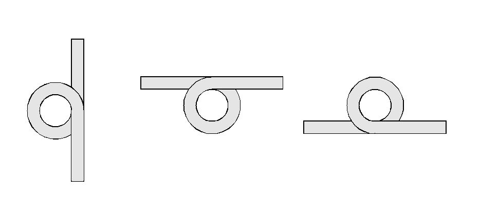

I have a question about siphon tubes. Is the idea that there will be a slug of water in between the gauge and the steam and that it resides in the siphon tube ? I have two options for my tube. the first one looks like this _o_ and the other one looks like this _ol .
If I use the first one in the opposite orientation than than it is shown above, with the loop "down" i can see how it would act like a trap and protect the gauge from live steam. If I use it in the orientation as shown above it seems like any condensate "plug" will just drain back to the boiler and the gauge will be exposed to steam.
I would like to use the second option in the orientation shown above, coming out, making a loop upwards, and then finishing poiting upwards. My gauge will mount handsomely on that set up. As I look at it though I dont see how it will protect the gauge from live steam.

Any of the shown orientations will protect the gauge from excessive heat from steam, with the gauge connected to any end in the three figures.
